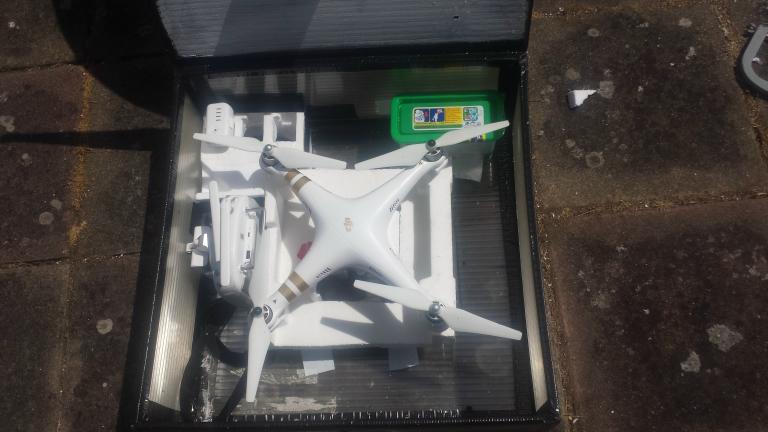

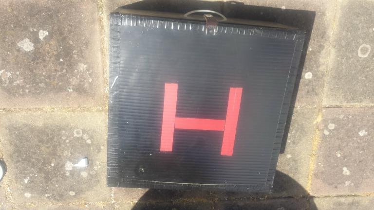

when I first had a P1 I felt the same as you so I made this box from polypropylene sheeting (old carport roof) just fixed together with duct/gaffer tape, and used polystyrene foam inside to hold the quad in place also a 3"square of foam stuck to the inside of the lid to hold it in position, and it was so strong that I could even stand on it!! internal dia was about 21"x21" you could also use any light material, thin ply etc, it held everything I needed to fly plus it made a handy takeoff and landing point before I got used to hand catching.
I've just placed my P3P and TX in to show how it looks with the props still on, I now use the DJI backpack but am giving this light box to a friend who has just bought an P3S
