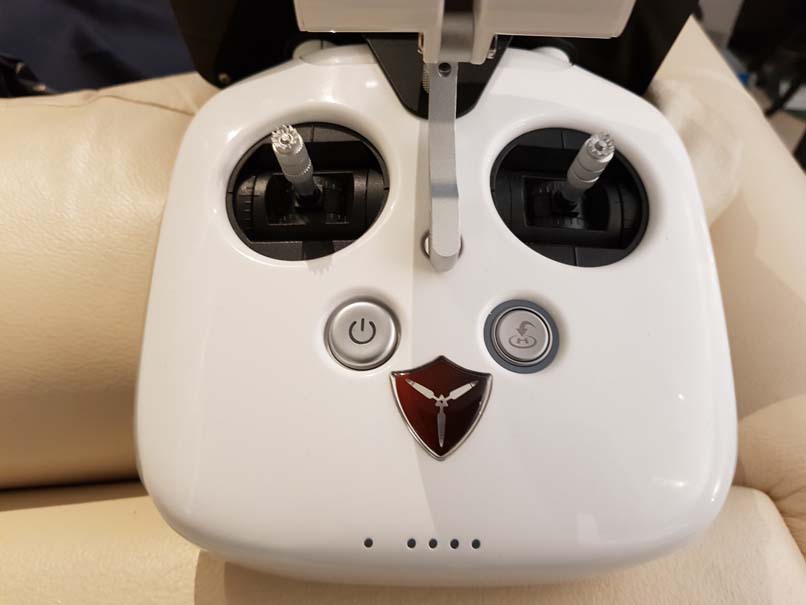

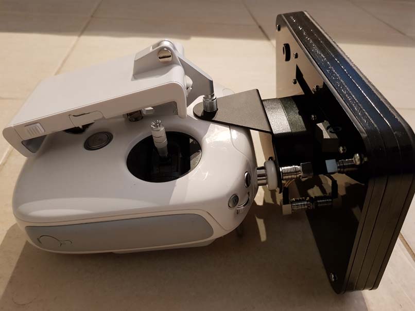

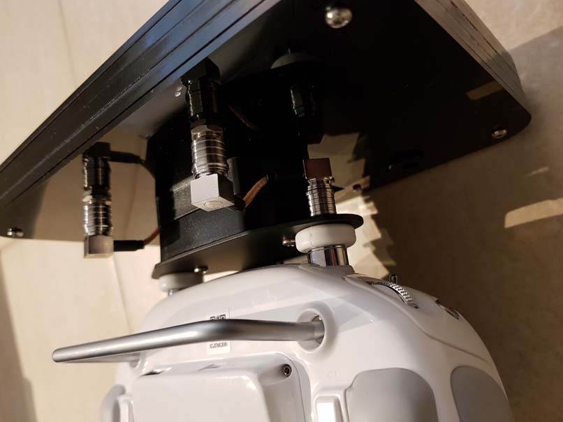

I have just modded all my spark, mavic and p4p controllers for the Titan Cylcone and have the Atlas on order as well. Flying the cyclone you definitely have the signal strength for a long way, battery power is exceeded before the signal wanes. As noted by previous poster, the angle of flight is important to maintain the signal for super long distances, but I have pointed the antenna panel down and have stood facing away from the AC and have still got a full bar connection when it's closer in.
The super performance , clean and simple mounting bracket and the self contained antenna unit have made me a Titan fan :)

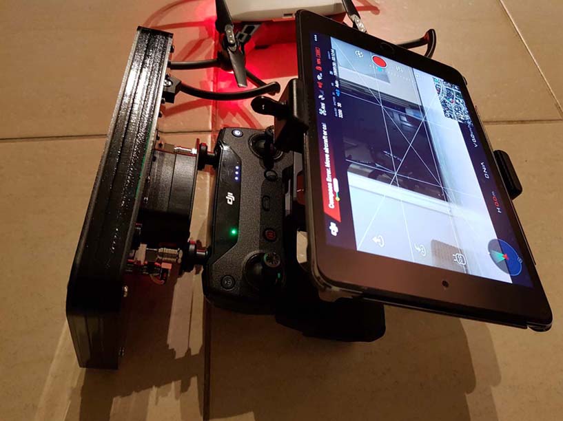

The spark and mavic controller form factor

The cyclone antenna performance far exceeds the range of the Spark batteries, so it's a bit of overkill on the spark, I only tried the Titan Cyclone on the spark because I had bought it for the P4P and Mavic , which could make use of the extra signal range.
An un-amplified circular polarised system would probably be enough on the spark.
Something like a https://www.amazon.com/Controller-T...e=165953&creativeASIN=B074K2C326&btn=imglarge
From a modification perspective the spark controller was the more difficult it has a multi tiered circuit boards with some very short ribbon cable that needs to be reconnected, in order to to change the antenna mount points
