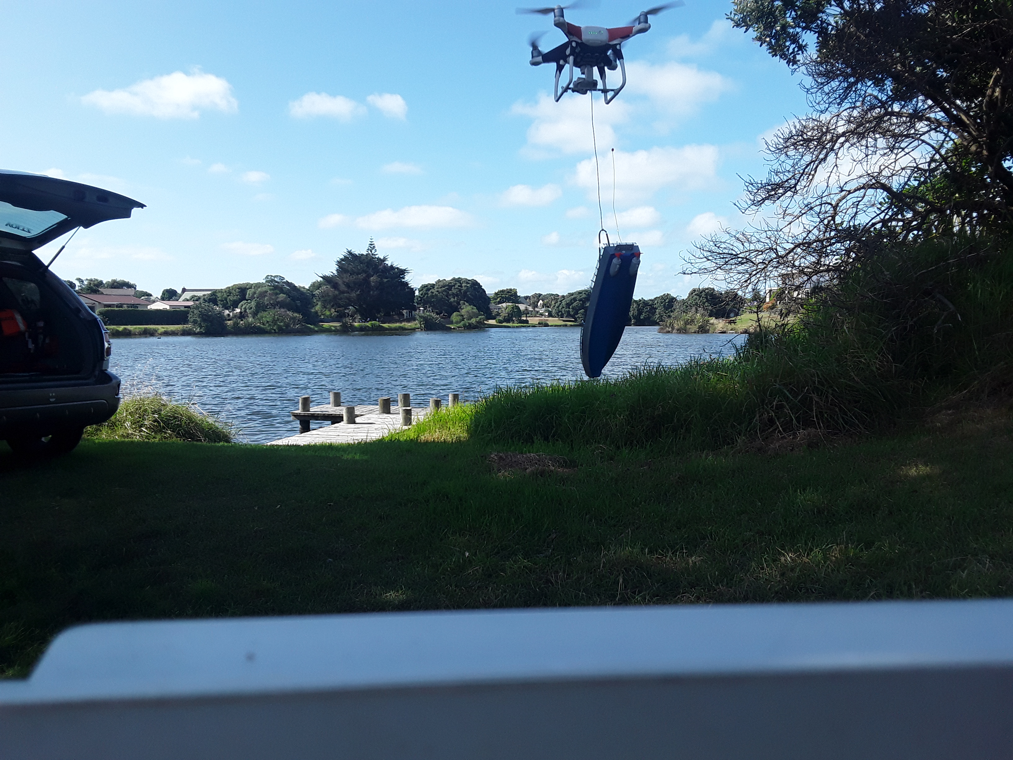

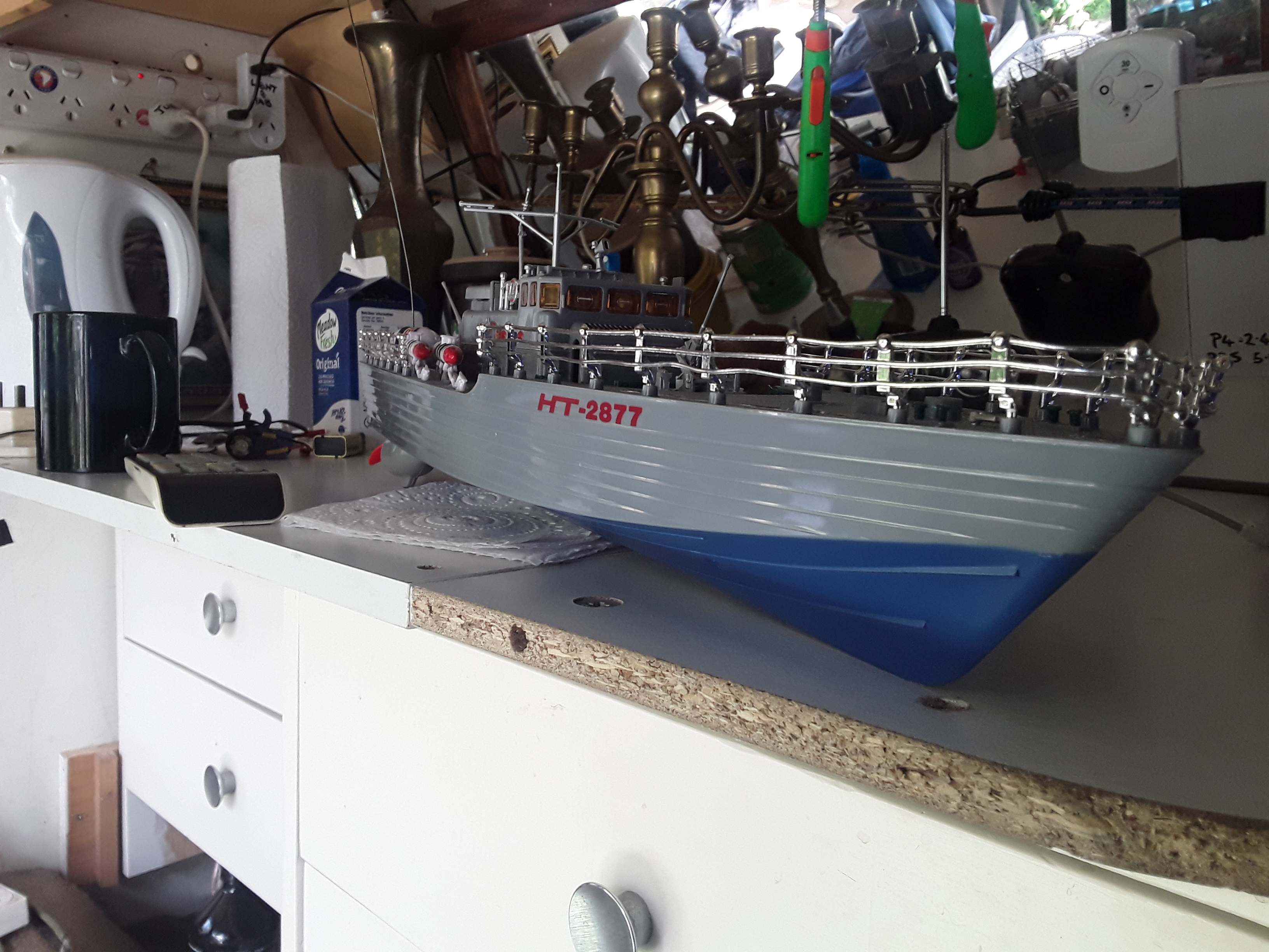

Well interesting day,got a model boat twin electric motors and not watertight and fills with water,first test and retrieval cause weeds tangle props causing 1 wet foot,aaarrrggg,hate that,second attempt batterys flat on the lake and took multiple attempts to hook but the p4 got it eventually, p4 was not happy in sport mode lifting this and was lucky I not put it in the lake with the boat,couple pics from today,,yip boat on drip dry mode ha..what good is a boat that fills with water..think I'll stick to flying :):oops:

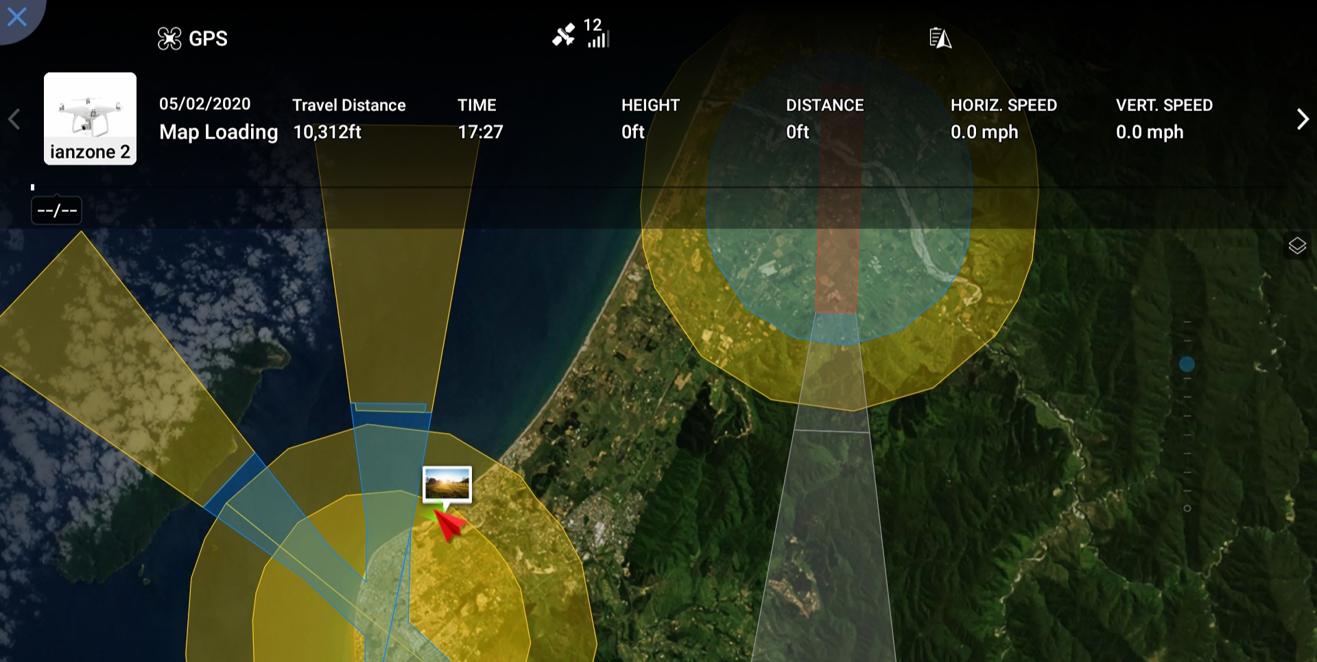

Stayed low cause kapity airport bit to the left as it kept reminding me...where abouts are you ?.
Me right in warning zone

Any ideas how water's getting in ? My boats - I always do a test in the 'bath' first ... with lid OFF !
If I can help solve it - as a model flyer / boater etc. ready !

Worked out its water running a cross deck and down into battery box which slowly filled the the hull up,insufficient battery box rubber seal,

Ha yeh put some wire between boat just incase but was fast idea and took multiple attempts to hook it with brass bronzing rod off drone,it needed to be way longer as rotor wash was moving the boat around, I nearly gave up but got it ,even with cam panned down it was so hard to see
Anytime you carry a heavy loads, It's best to keep it about 10 ft under, to keep the load from swinging. Learned that from carrying heavy baits for fishing
A good seal is door foam draft sealer strip. Its self adhesive and easily compressed as the lid goes down.
In the old days - we used 'clear sandwich boxes' with press on sealing lids.
