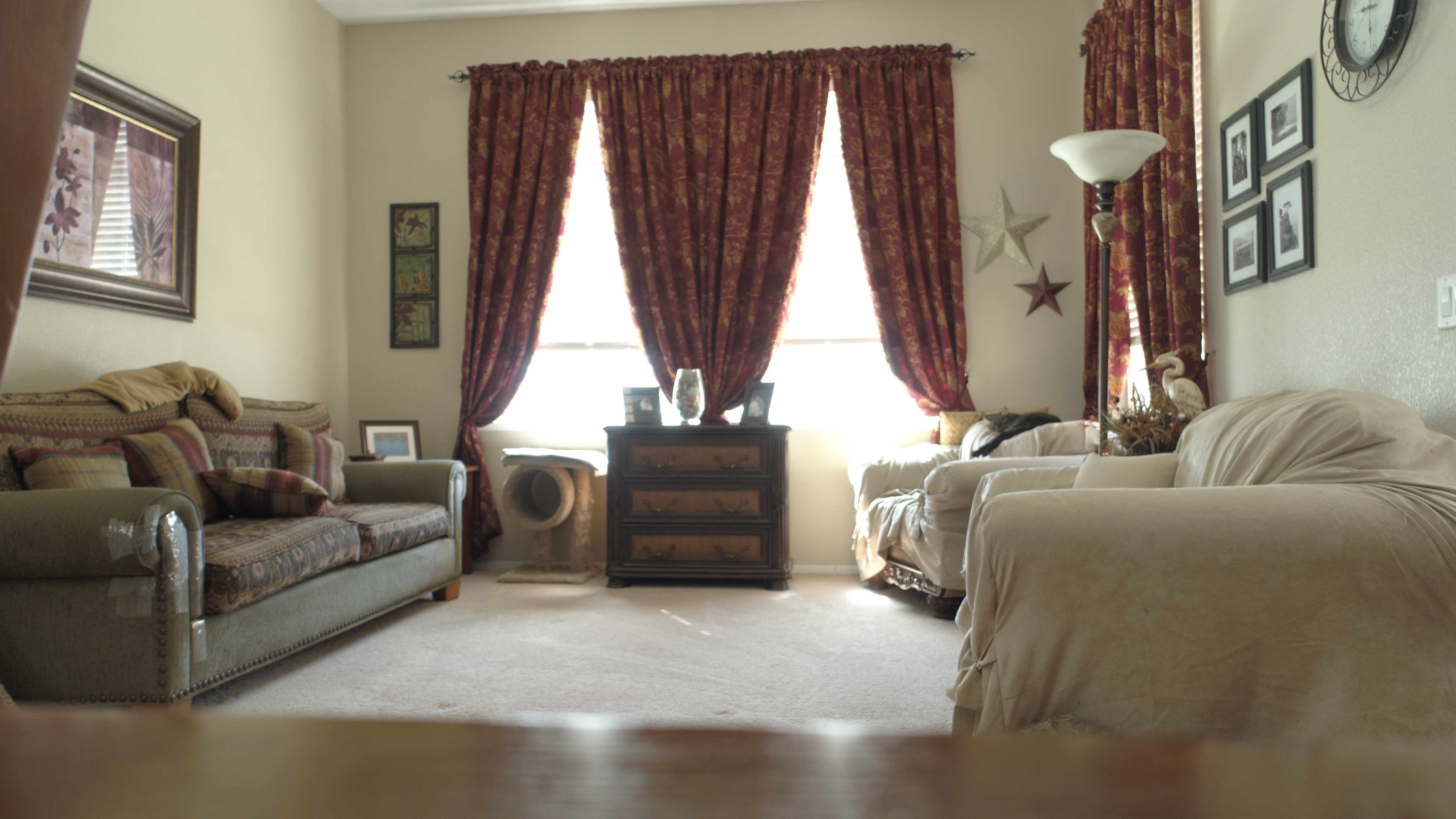

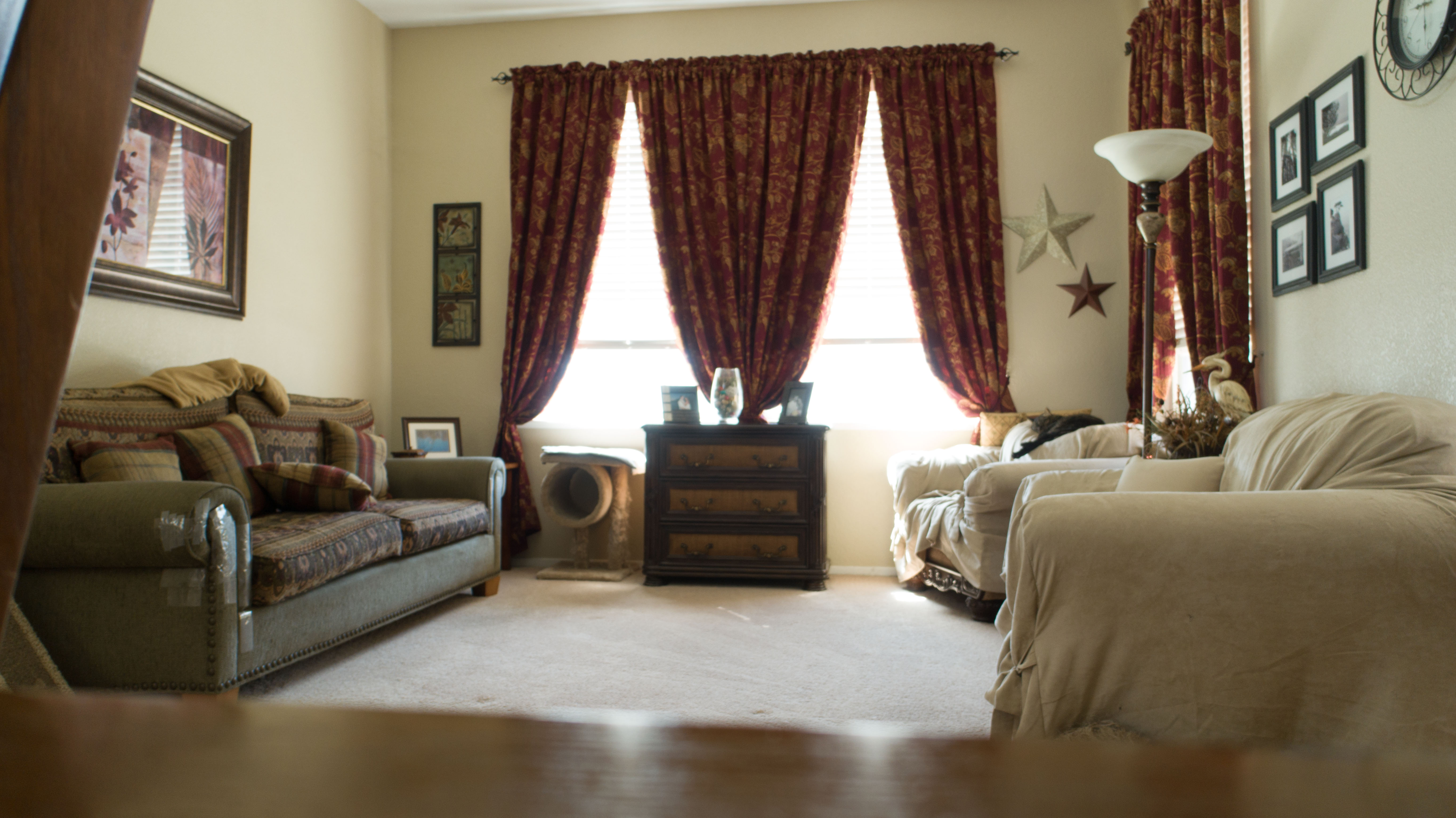

So I just got my p4p and I have been taking some stills with it and they are not in focus. Shooting raw in auto. I thought it was me initially when in "A" priority but I set it on the table with the props off and they are still blurry. I have a shoot on Monday and didn't want to have to use my mavic. Any suggestions? The jpeg's seem a little better than the raws. the first one is a raw converted to jpeg the second is a straight jpeg

tap on the device screen to select the point of focus or you can toggle on/ off the AFC
Yes I have been using auto focus. Tried manual and it didn't seem to work either but that was inside my house and I figured the distance was too short to properly work. Gonna go put it in air out front and try it again.

So I just got my p4p and I have been taking some stills with it and they are not in focus. Shooting raw in auto. I thought it was me initially when in "A" priority but I set it on the table with the props off and they are still blurry. I have a shoot on Monday and didn't want to have to use my mavic. Any suggestions? The jpeg's seem a little better than the raws. the first one is a raw converted to jpeg the second is a straight jpegView attachment 96915 View attachment 96915 View attachment 96916
Your subject and lighting aren't a good indication of how the camera will perform from the air.
In your sample shots you have elements from 1.5 to 5 metres away.
You will never shoot a scene like that when you are flying.
You'll never focus that close or have objects at different distances to focus on - everything is going to be 15 metres or more away.
Wait till you fly and you'll find the camera is just fine.
