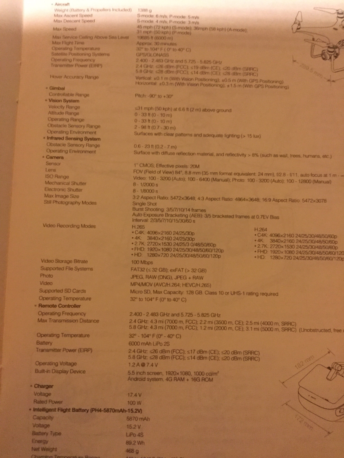

This is the specs included with my phantom 4 pro plus obsidian
I've never filled up my 128 gb card, but I'm thinking that if both my P4 and MP recognize it and format it as a 128 gb card, that it can record the full advertised card. It has been windy here lately, but I will try to fill up the card with video and images just to make sure it will at least go past 64 gb.
Reactions: oconnb
It will.
