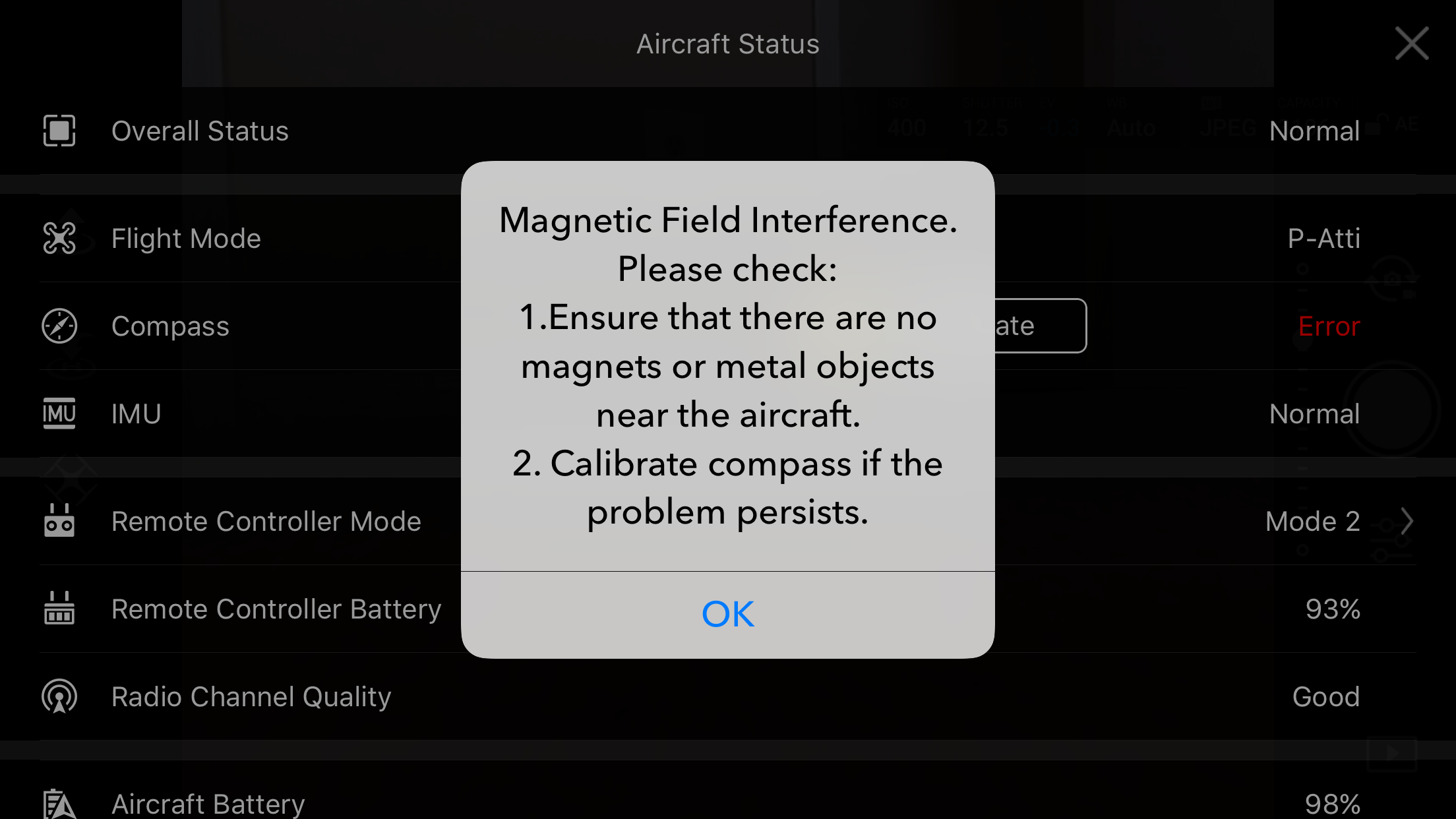

I crashed my phantom 3 4K the other day. now it won't take off anymore. when I slide the auto take off. It brings up the settings. and when I try to manually take off it does the same. please help. I'm not trying to pay a arm & a leg to send it in to get serviced.
Is that all it does? Brings up the settings? Are there any other messages that come up?

No need to apologise. Where do you have the Phantom when you are getting these messages? Make sure it is away from any potential source of interference, including metal structures, reinforced concrete, power lines etc. If you are sure you're nowhere near anything like that, then try to do a compass recalibration, and then try again.

Ok. I'm at home right now and there's nothing but a lot of cars around. But I've flown here plenty of times. I don't understand. but I'm about to go find a big open field to try it.

When I have a crash, I like to take the top off and go over everything with a magnifying glass to look for dislodged plugs, broken antennas (incl. the GPS antenna). And while I'm at it, check the plastic frame for cracks. Check the props of course. Check everything for any kind of visible disruption. That's the first thing I do whether I think it'll fly or not.

Have you tried a compass calibration. Theres a demo video here:
If you try that and it still happens, then it's possible the compass module is broken. Luckily if it is, they're not too expensive and not too difficult to replace. Of course this assumes nothing else is broken.

well guys. I tried to calibrate it in a open field. and still the same problem. Won't take off and the compass error is still coming up. It's saying I'm around some type of magnet or something.

Yea I tried all that. I even had my wife hold the remote yards away while I hold the drone. Still nothing. it's still saying something about the magnets around. so when I get home I'm going to take it apart and inspect the inside of it.
Great news guys! After taking it apart. I found out the compass cable came loose. after reconnecting it and calibrating everything. the bird flew like a champ. I really want to thank all of you guys for helping. If it wasn't for you all I would've been out of lots of money taking it to get it repaired. thank you. thank you. thank you again!
