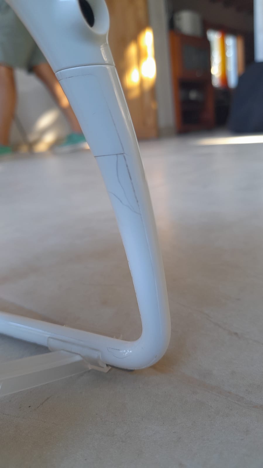

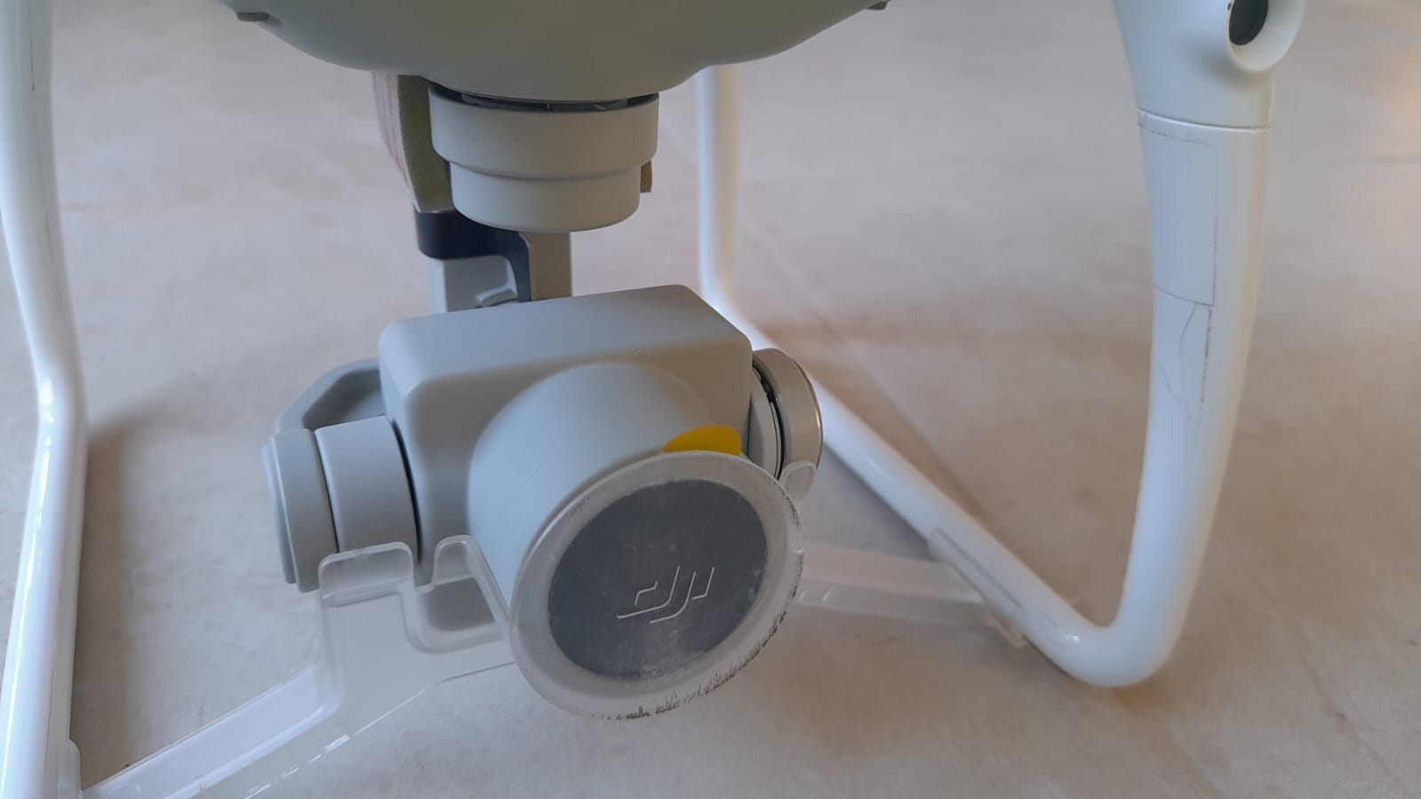

This is the issue, is there anything to remedy it? I will be traveling to Argentina early on the 31st and this drone is in Argentina with a friend.
I’ve seen these kinds of fractures a few times. Is there some form of malfunction related to what’s seen in your pictures?
