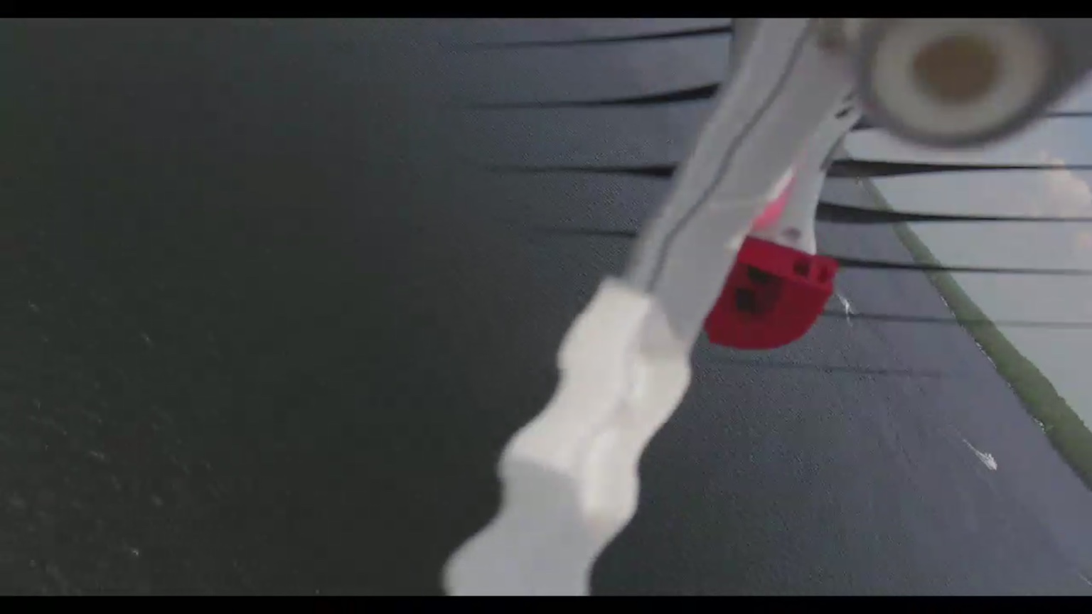

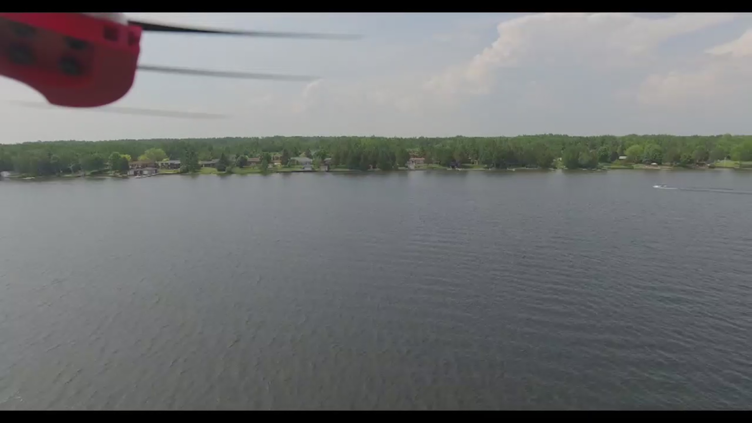

Here again is the difference in how the props looked before things went wrong compared to as things were going wrong... Do you still think it's just an imaging artifact or does it look like they're actually stopped in the second pic?
Before any trouble started...
Just before I lost connection...
And as a special treat, here is the final 11 seconds of video - after things had gone really wonky but then appeared to stabilize for 5-6 seconds....
No, the prop is definitely spinning in these images, it's just a camera sensor artifact. But the second picture seems to show a great deal of vibration (the landing strut looks like it is made if jello). To me, the steep angle of the horizon also seems to indicate some kind of propulsion failure. A broken propeller or a broken motor would be my guess. Sorry for your loss.
If a prop had fallen off, there's no way it would suddenly be that stable for 5 seconds before suddenly going crazy again. My vote is a bad motor.
Reactions: Tenly
Yeah, I thought maybe a crack in the propeller that escalated into a breakage... But I think you are right, a motor malfunction seems more likely. Guess we'll never find out.
//Tom

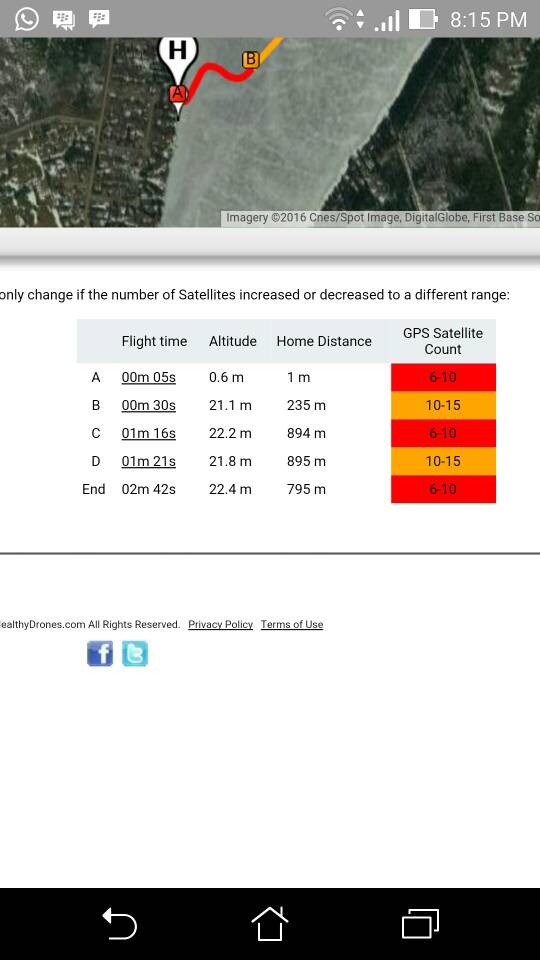

You should not force to fly if gps reception not good. I see first 1M its a'ready red... 1464783382065.jpg

You should not force to fly if gps reception not good. I see first 1M its a'ready red...View attachment 55707
Ease up on that judgemental tone there cowboy.
If I had that data before my flight, I would definitely not have flown - but maybe I can help educate you - the charted data you are looking at is not available until AFTER the flight is over! As soon as I saw the chart data, I tried going back in time and "not" flying - but I couldn't find a way to do so. If you have one - please share!
When I took off, I was looking at a big green "Safe To Fly (GPS)" and a connection to 11 satellites. Throughout the entire flight, I remained connected to 9-12 satellites and I did not have any indication of an problem until the first "GPS Signal Error" appeared in DJI Go after the 2 minute mark
Having said that though - the Phantom should be perfectly capable of stable flight without GPS. It may wander and drift with the wind - but it should maintain altitude - not dive into the water.
