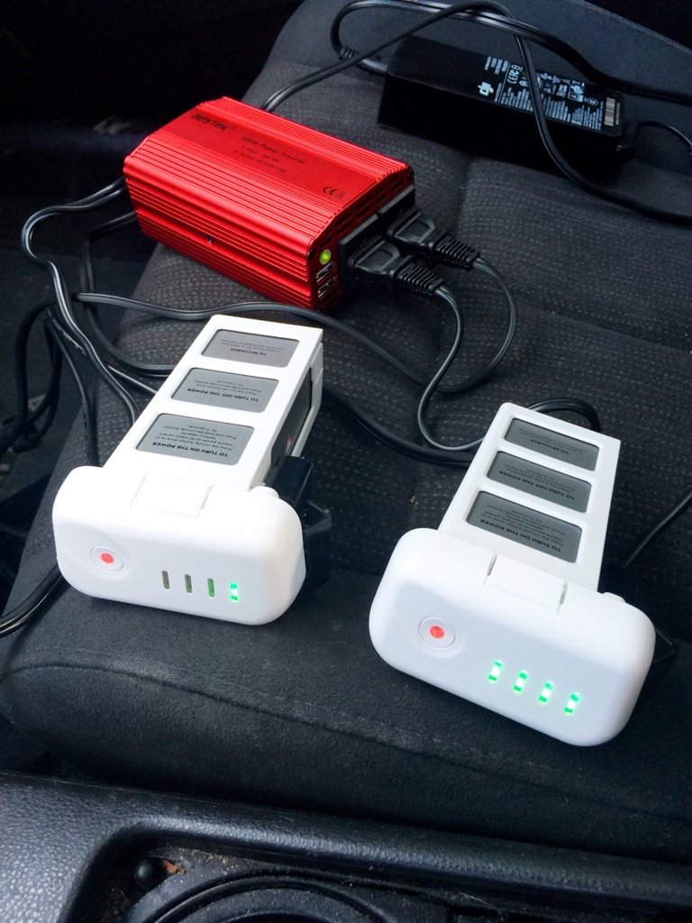

Got my backup P3P today! Using the remote control (my gimble wheel has a loose connection and stutters moving downward) and the battery. Out flying, and using the inverter to charge both of them in car!!
Working like a champ!!

Awesome setup. I have that inverter but it kept turning off during charging. Hmm...
It was a little finicky at first........... I wound up cooling it off in front of a vent too lol!! Then it worked fine, may have gotten a little too hot in the 96 degree (over 100 in car!) weather we're having.
