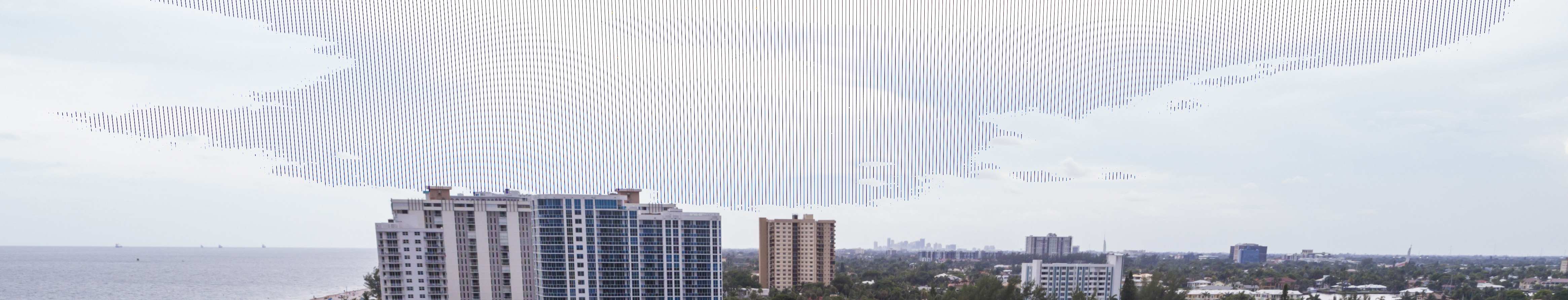

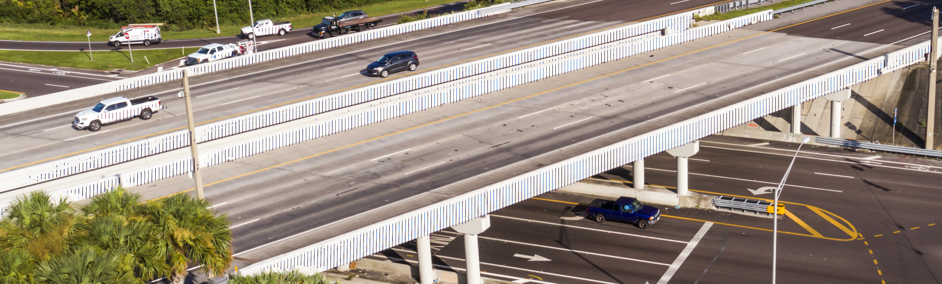

These are 100% crops from P4P+ DNGs;
they only appear short & vertical, only over bright areas,
e.g. white cars, boats, buildings, but only ~25% of time,
especially dominate some white clouds, but not always...
Anyone else experience this specific artifact & cause?
Don't guess its moire, as its not appearing over patterns,
although resulting artifacts create "moire-like" effect if
not viewed at 100%... Thanks in advance.
(please be sure to click zoom tool to view @100%!!)
Note: how do I deliver sample full DNGs to DJI?
Strange! Is your over exposure warning turned on? Might be that.
Jim
WA5TEF
Not aware it is.
But that effect should NOT be captured in a DNG?!!
And there are many other images with bright white areas
that do NOT have these artifacts...:(:(:(
(adding to the confusion)
Weird. That looks similar to over-exposure lines, but those wouldn't be on the SD card images. Presumably this is something that just started happening?
Yes, after return from DJI repair.
Of course P4P+ has to go back, just wondering
if anyone has seen same & how resolved. I spent
3 bloody days manually PatchTooling-Cloning away
these bars from ~20 of 73 images!!!:mad::mad::mad:
(& results are sometimes sloppy at 100%)
