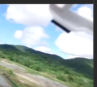

yes you can see wings flap as it comes in for the kill.
ok, yes, i just downloaded your video and put it into my video editing package.
its the drone leg o_O
what i thought was a wing seems to be structure of drone.
