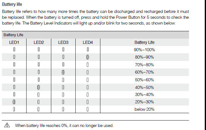

If you look in the P3A full manual, there is a section about the battery where it tells you how to check remaining life.....press and hold the on button for 5 seconds, and the LEDs will indicate % of life left. Down load the manual and check.

Here is the chart on page 20 of the P3P manual.
Hey, thanks for the reference to the section in the manual. I didn't remember reading that section before. (and I've spent a lot of time in that manual)
According to that method in the manual, I have 30-40% charges left (not the 68% in Litchi) so since I've charged it 130 times, that's 40% of 325 (calculated). I guess 325 charges is the expected service life if I'm in the norm, which, according to my cell voltages, I am. That's a lot of charges left. Successful flights? Who knows.
Right now everything seems normal, but I will save the older battery for local flights. And as Mark the Droner says, it will be good for bench work.

I did this test to on P3P battery to, only had two lights (50-60%) but on healthy drones battery life was shown as 80%.

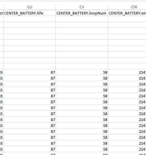

The TXT file the aircraft generates each flight has the most battery info of anything out there. The image below only shows the Life Percent and number of flights. I only gathered based on what the OP mentioned in his original post.

You're right (as always). The FLY.csv file really gets into it. I looked at one for my new battery. I'll check out the file for this older battery.
