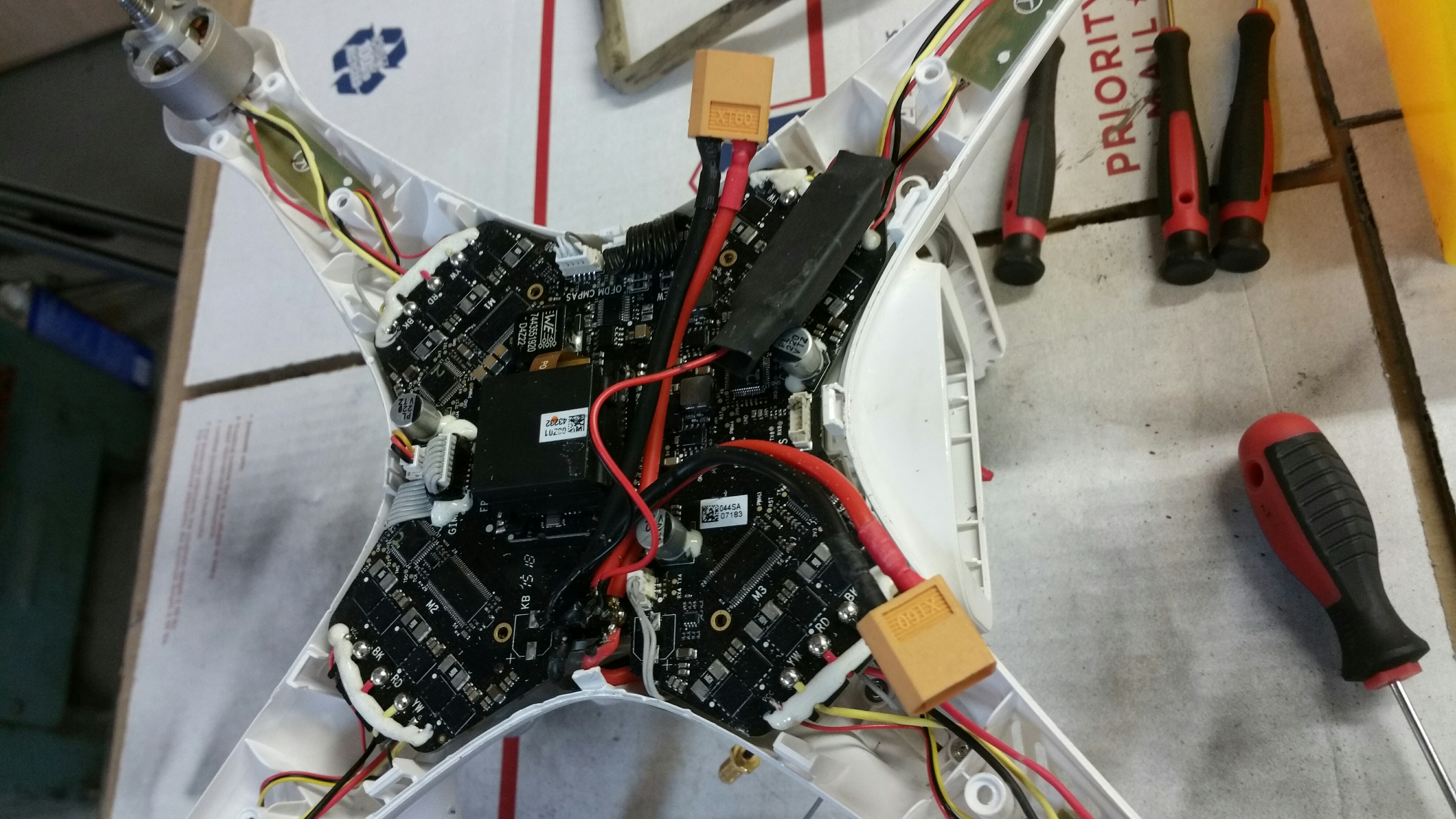

In Canada I will do the battery mods for inspire and for p3. Either to the battery or to the drone. I'll update the site tomorrow but droneshopcanada.ca I've gone with mount you put on the side of the legs so you don't have to remove landing gear every time you want to put your drone in a case.

You can use 4s batteries on the p2 I actually have the modified cap that MaxAmps makes it has a balancing tap on it where you plug in the 4s lipos it essentially tricks your p2 into thinking it's a 3s battery.
