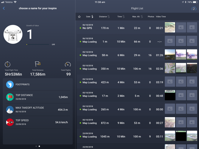

The P 2 vision + camera view saga continues BUT a bigger obstacle arose last weekend. Our son Matt took the P 3 advanced to the top of my brothers 500' high Mt Emu in Victoria Australia that has a Continuously Operating Reference Station (CORS) installed on the top. Matt conducted the correct checks and took off and after 16 seconds tumbled out of the sky. :(
YouTube
Thoughts please.
Aussie Paul. :)
The attachment doesn’t help, at least I can’t see how it might. What would give you a chance of understanding what happened would be to upload the flight log to phantomhelp and share the link to the flight here. There are plenty who will do some analysis for you.

Hi Paul, Victorian flyer here too, curious on a few things once you post the flight logs. The picture you posted on the first post indicates Inspire AC? What is this picture intending to show? Did you retrieve Phantom? Any damage / reasons you suspect caused it to fail? as very unusual just to drop like that. Cheers
Hi Loz from here in Ballarat, pretty dumb at all this stuff. Fortunately our IT capable son Matt (who crashed it :) lives two doors away!!! :) They retrieved P 3, lots superficial damage to plastic stuff. Gimbal and camera ok. The "vision" pcb under the VPS has had the socket pulled from the pcb!!! :( Trying to locate a parts list for my P 3 and P 2 so I can order parts.
