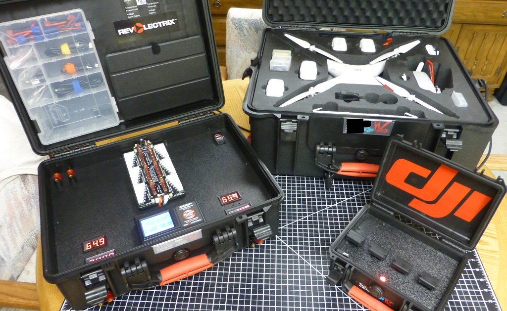

You are correct Achilles, the chargers are little more than power supplies. That's why I don't use my big LiPo 1500W parallel charging case to charge my P3 batteries. That's why I built a separate charging case for my P3 that just has 4 "adapters" or "power bricks".
