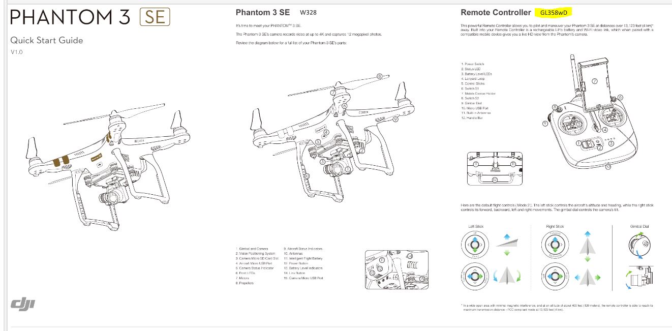

I just sent one back to a guy who advertised a new one that works with the Phantom 3se but it was unable to link to the aircraft and I was surprised. Apparently they are all on a different frequency.
As far as I know, the GL358wA is for a P3S and the P3SE uses a GL358wD.I just sent one back to a guy who advertised a new one that works with the Phantom 3se but it was unable to link to the aircraft and I was surprised. Apparently they are all on a different frequency.
If your drone came with a GL358wA, are you sure that you don't have a P3S and not a P3SE?My original that came with the Drone from DJI is the GL358wA. That is the one that worked.
PositiveIf your drone came with a GL358wA, are you sure that you don't have a P3S and not a P3SE?
You are right OsoAs far as I know, the GL358wA is for a P3S and the P3SE uses a GL358wD.
I'm not surprised a 358wA would not link with your SE.
I can't say that I'm an expert on the topic, just repeating what I've seen here on the forum.
