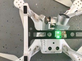

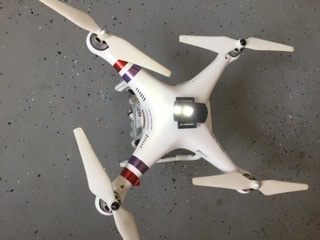

Great responses, thanks. Looks like I’ll put the strobe/light (meets FAA 3sm requirement) on top and the little bright strobe on the bottom of the gimbal protector. Yup, I’ll put an observer at the 3 mile point at night and log the info. I’ll post the results.

The photo doesn’t show on the FoxFury D3060, because the lights are too bright, that one faces forward and the other is on top of the unit. They both can be put on strobe or either can have a steady beam. The write up in Rotor Drone Pro magazine shows promise for a unit that weighs 37 grams. I’ll post more when I test it.
