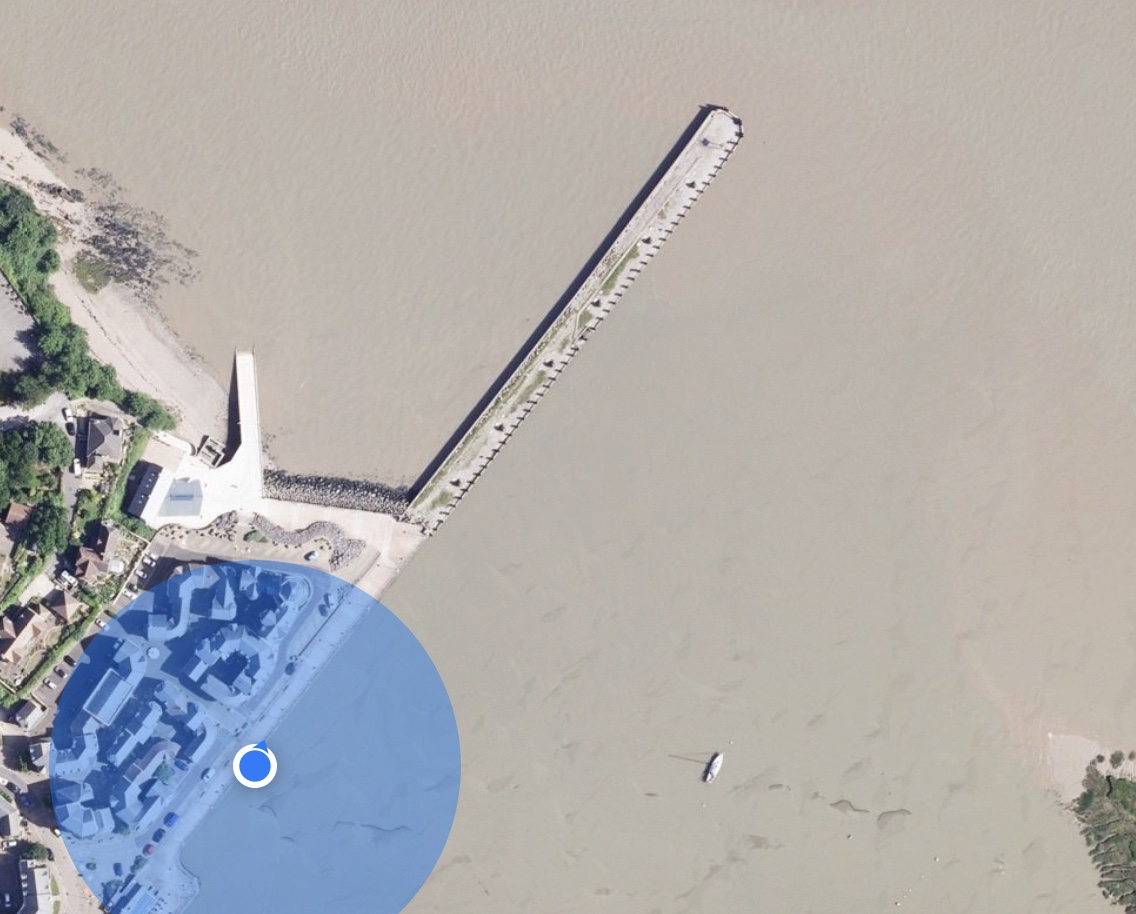

I live near a short pier which is very convenient for flying as it takes me over 150m away from built up areas, people etc. When I flew my Mavic Pro from there I had no problems at all but since buying my P4P I get all sorts of problems, transmission drop-outs etc.
I wondered if the construction of the pier is affecting things? The pier has old railway tracks embedded in the surface and the many bollards you can see are all metal capstans previously used for roping up ships.

View attachment 104038 I live near a short pier which is very convenient for flying as it takes me over 150m away from built up areas, people etc. When I flew my Mavic Pro from there I had no problems at all but since buying my P4P I get all sorts of problems, transmission drop-outs etc.

Launching from the pier shouldn't cause the signal to drop out but if you are launching from reinforced concrete or close to steel you can give yourself serious compass issues.
