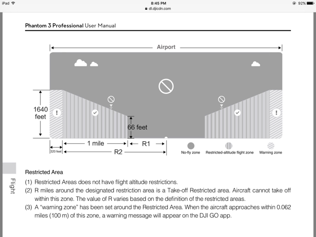

In a practical way how the "non fly zones" around 5 miles away of an airport works?...Should I call the Traffic Control Tower before flying the drone or not allowed at all?

I believe the no flight (motors won't start) limitation is within 1.5 miles of the airport. You aren't prevented from taking off within 5 miles, but your altitude is limited within a tapered cone out to the 5 mile radius. I live approximately 2 miles from BWI airport. The app (& aircraft) alerts me that I am in a restricted zone & limits me to 160' right at my house. If I head towards the airport, the altitude decreases up to 1.5 miles at which point it will let me fly no further towards the airport. If I fly away from the airport, available altitude increases out to 5 miles, as which point the limit is removed and the app/aircraft warnings cease.

"The value of R varies based on the definition of the restricted area?"
How does one find out the value of "R" for a given location? Is "R" always 5 miles for airports (in the U.S.)? If so, does the 5 mile number apply to R1 or R2?

Understood. However, those red circles are not "official" no-fly zones, are they? I am under the impression that they are created by various private individuals. I agree they are good guides, but there is no guarantee of their accuracy. In the event something bad happened or the operator was fined for violating an airspace rule, I am not sure those red circles could be a defense. I don't know the answer, but I still would err on the side of caution when using that kind of data.

The red NFZ's were set up by DJI and enforced in their software, not by private individuals. Technically, the P3 will NOT fly in to those zones and will limit it's altitude the closer you get to them.

I didn't realize the graphic was DJI one. There are several apps out there which have their own list of no-fly zones. DJI is not the FAA. I probably should have indicated "private parties" as opposed to "individuals." My point was that these red zones are not all inclusive. There are some airports I know of which are not included in the DJI app.
The DJI limit is a good thing, however the point I was trying to make is that they are not "official," not necessarily "accurate" and certainly not all-inclusive. Some common sense and one's own research should be used in addition to any of these software aids. Don't assume because the software is not limiting you (or another app doesn't list your area as a no-fly) that it is safe or permitted to fly in a given area.
