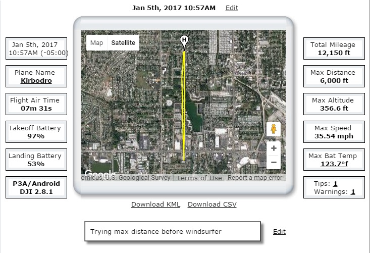

Nov_Zero_One I have bought a couple windsurfers, a cheap one from ebarf and one from the originator. I actually have not tested them yet, but I want to do a side by side test. To establish a baseline I picked a clear day and flew from my front lawn over a residential area then an industrial park with a Home Depot. Given these conditions, I thought my little 3A did fairly good. I wonder how much additional range a WS will yield.
