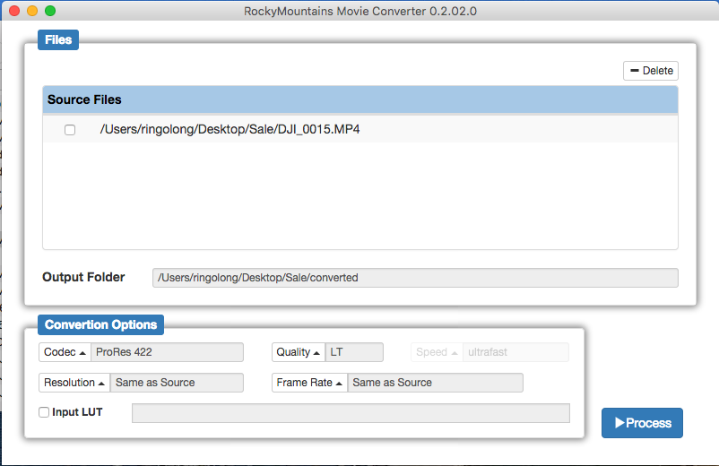

This is what I have been using.
Reactions: maseman88
h.265 will be higher quality, but the conversion to ProRes is pretty good.
