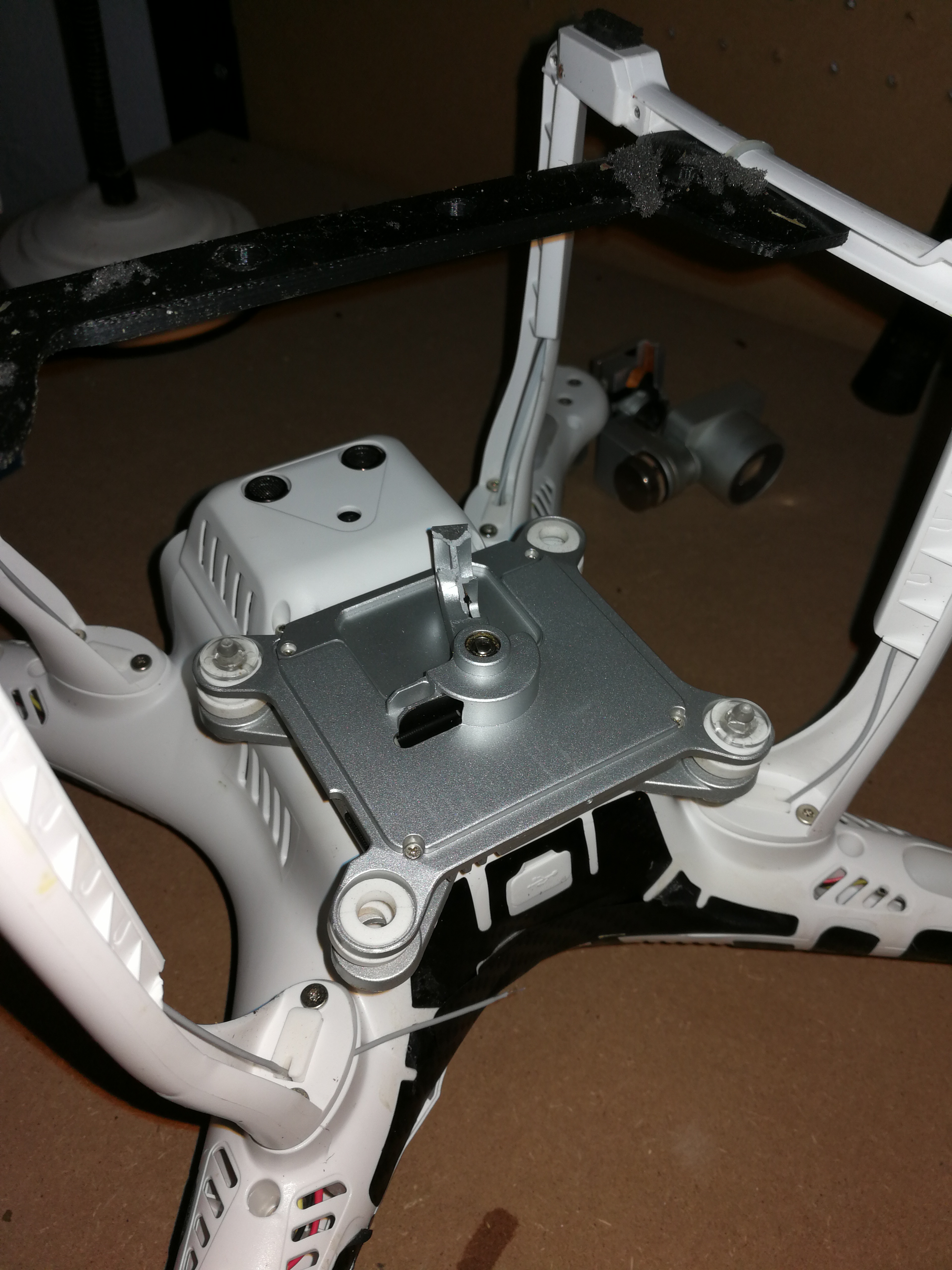

Hi there,
I've got P3 Advanced. Unfortunately, I had an accident and dropped from sky, resulting in the arm that holds the camera cutting off. It's now repaired and a new flex has been installed, but it goes crazy. Please see the video attached and let me know what your thoughts are. Is it maybe a further problem? Like a cpu problem?
Thanks very much for your much appreciated help.
