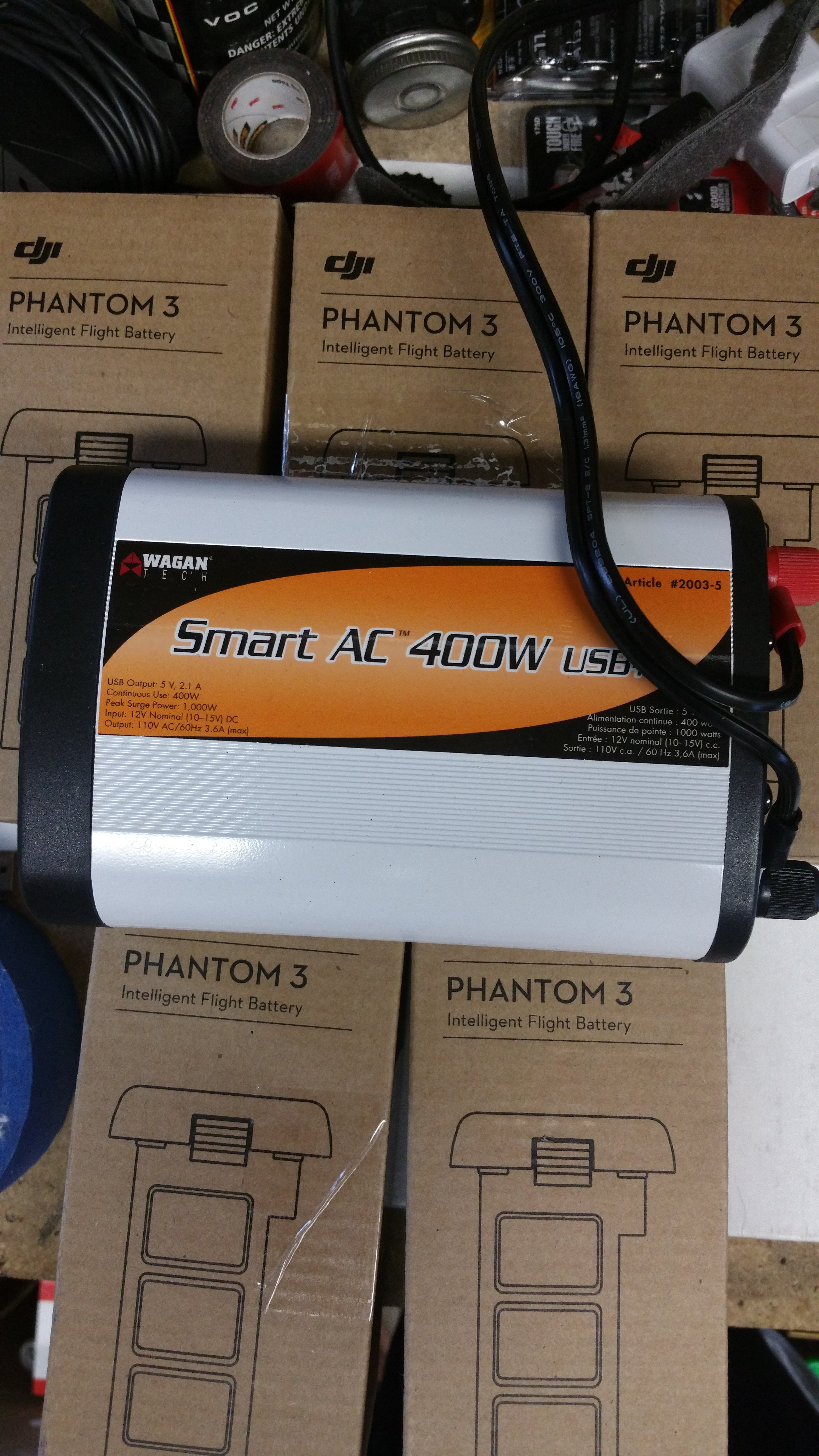

I know your trying to show the charger, but all I see is them batts lol
Lmao. I realized that after I loaded the picture hahahaha I had just opened them all to charge haha.
