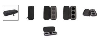

Here's a neat tip (I think so anyway) for those of you who have purchased the DJI ND filters for your DJI Phantom 4 Pro but have no case to keep them secure in. So far I haven't been able to find a case for them anywhere. Even DJI doesn't make a case for these ND filters.
So, I went to Amazon.com and purchased an Anbee Lens Filter Case for DJI Phantom 3 or Phantom 4 filters. Now, we all know that the filters for the Phantom 4 Pro are larger in diameter than the earlier Phantom cameras so here's what I did.
First I removed the rubber sheet that holds the filters (it just lifts out). Then I took a 1 3/8" Forstner bit and chucked it into my drill press and carefully aligned the bit over the center of the original hole and drilled down to the bottom of the hole. The 1 3/8" Forstner bit makes the hole the exact size needed for the new DJI Phantom 4 Pro ND Filters.
Here's the link for the filter case on Amazon.com https://www.amazon.com/gp/product/B01IHE9CZ4/ref=oh_aui_detailpage_o00_s00?ie=UTF8&psc=1 and it's only $8.99 with free shipping. It's a great deal and a great case for your new Phantom 4 Pro ND filters.
It took me all of five minutes to do the job and I don't have to worry about my DJI filters being damaged when travelling in my Nanuk hard case.

Glad to be of help. I was out flying with a friend yesterday and was using my modified lens case and it works just great. It fits inside my Nanuk 945 case just fine and it's a great way to keep our ND filter lenses safe.
Good luck, and just remember to remove the insert from the case and place it on a piece of wood before you drill the holes out with the Forstner bit. That way it gives it some strong backing to drill against.
