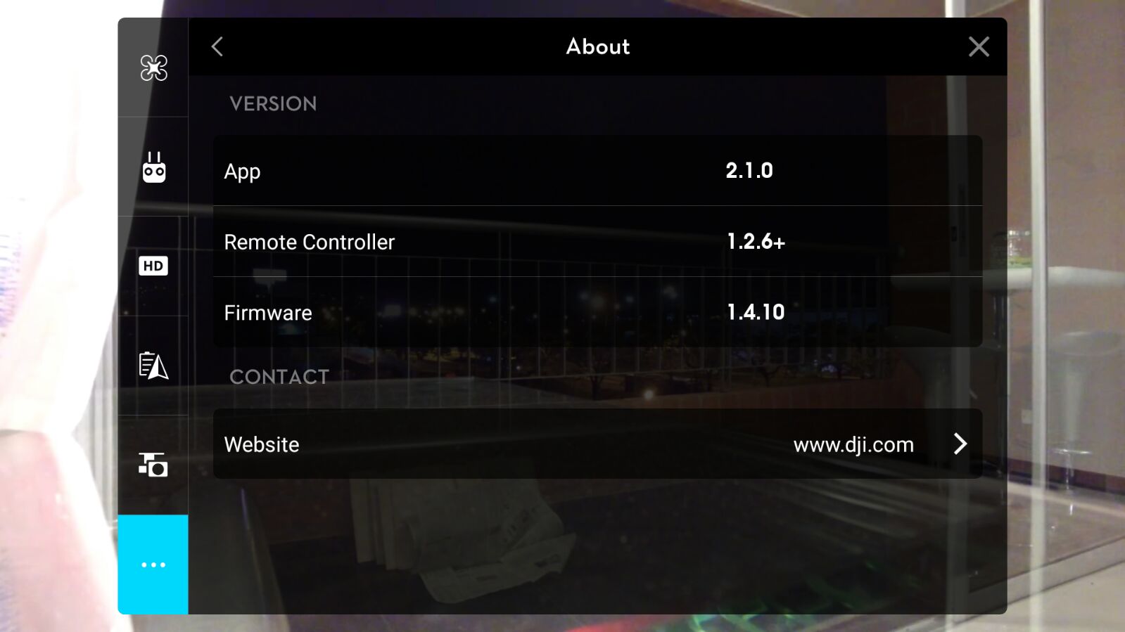

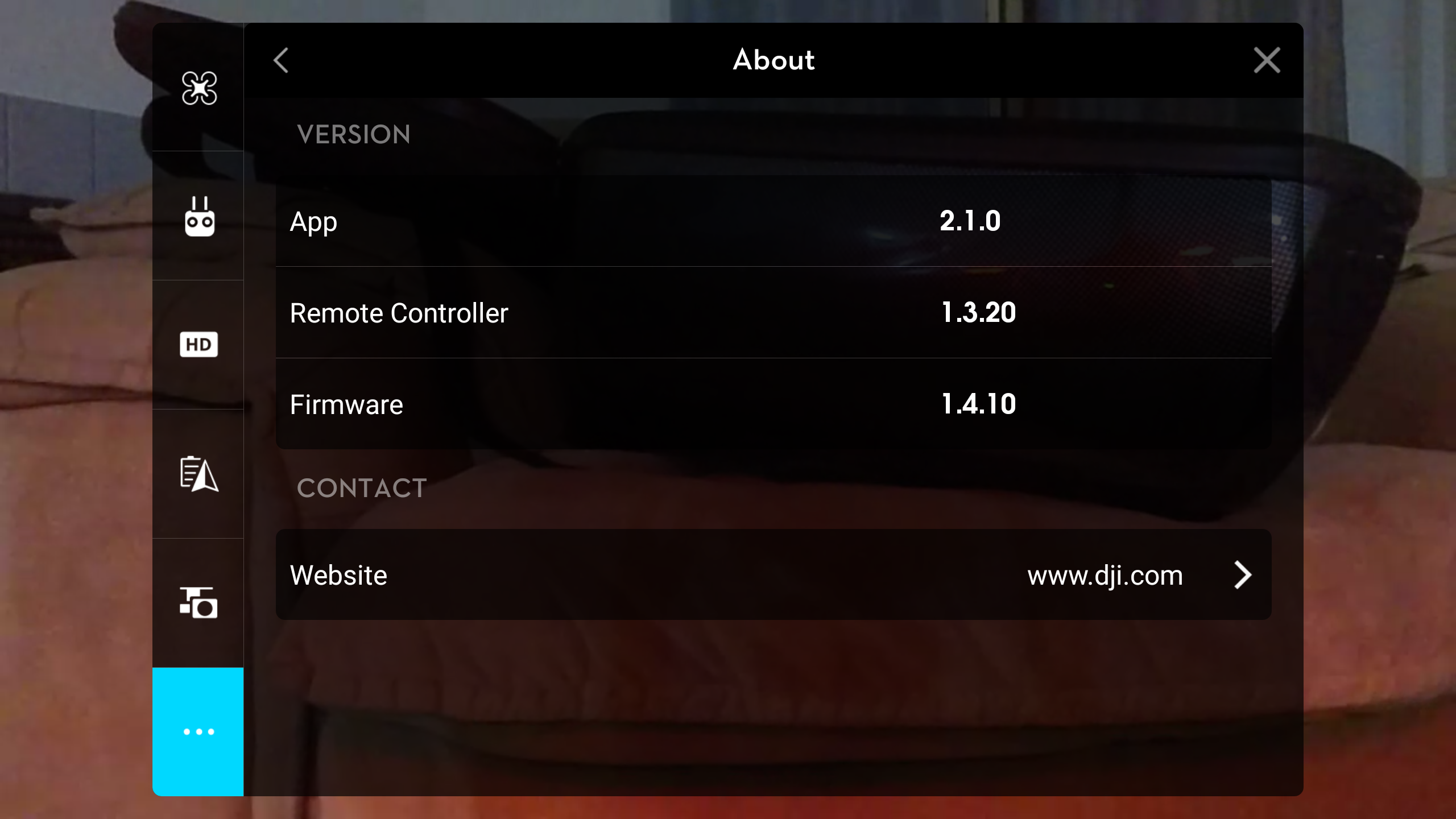

Both Phantoms 3 Pro are up to date , is there anything wrong with the Remote control "version"?
