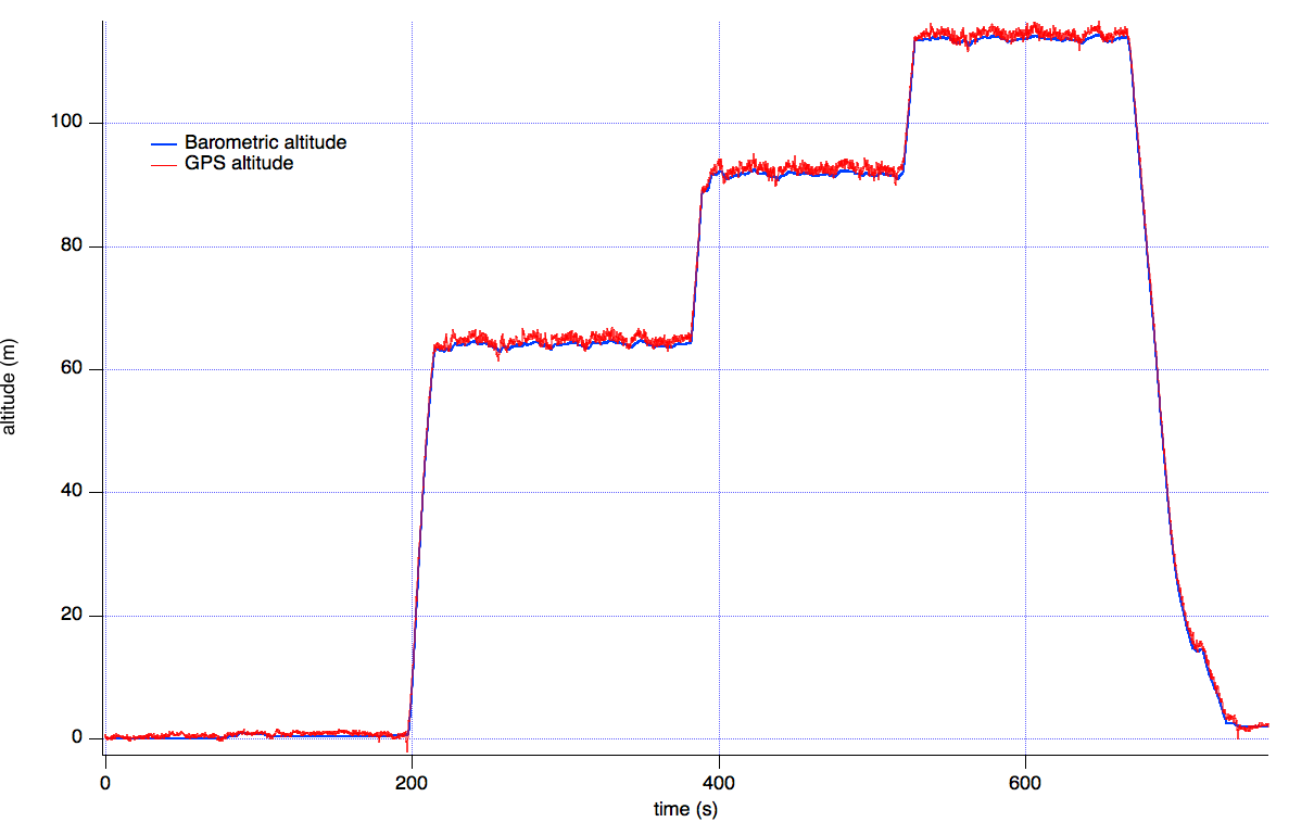

@Meta4, @DefiantChild - in case you are interested I pulled the GPS and barometric altitude data from a DAT file conversion that explicitly included both. Below is the comparison for one flight lasting around 13 minutes. The first graph is the simple comparison (with the GPS altitude zeroed at the start). Note that the GPS alttitude fluctuations (noise) are much higher frequency and larger than the barometric altitude fluctuations.

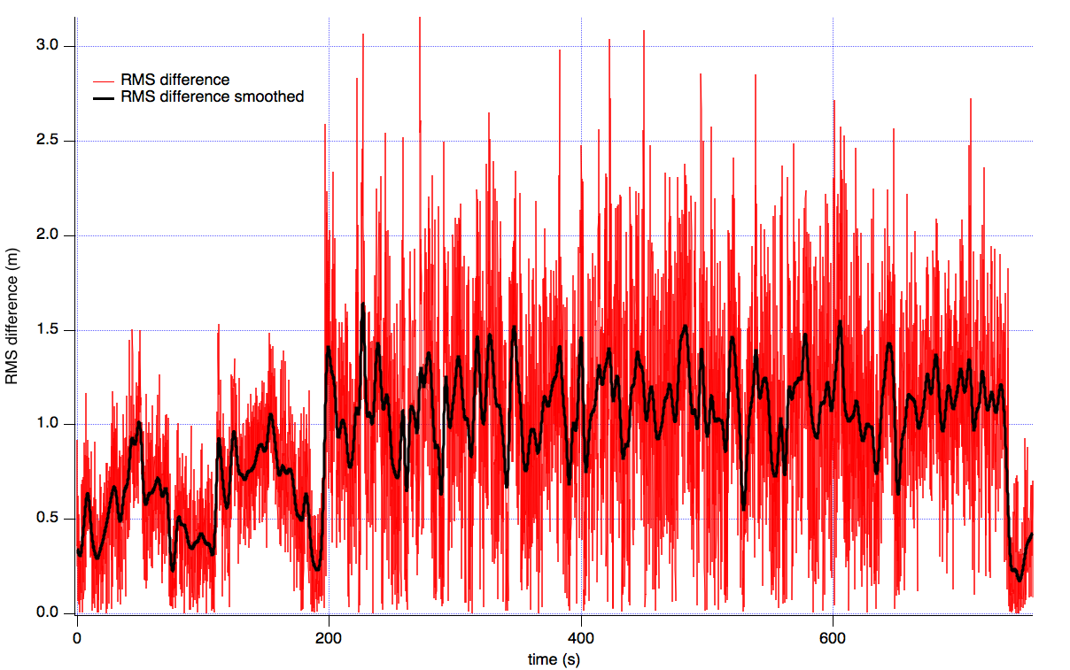

The second graph shows the RMS difference through the flight, raw and smoothed.
In terms of the overall data, the average RMS difference is 1.1 m with a standard deviation of 0.5 m and a maximum (unsmoothed) difference of 3.15 m. The agreement between the two is very good and illustrates that, at least for this flight, the GPS altitude, at least in differential mode, is much better than some conventional wisdom suggests, and is also comparable to the expected variations based on relative errors in the vertical and horizontal dimensions. The fluctuations in the GPS data, even when smoothed, do give a clue why barometric altitude is preferred for flight control.

Gotta say, it's rather refreshing to see a little empirical evidence on this subject. I have no idea why DefiantGuy insisted on burying a simple point of view in a mountain of techno speak.
