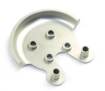

Those other stand offs make no difference as the plates rest flush against the arm at those points, the sleeves on those four holes do not rest on anything, they just slightly go into the screw holes. They do nothing. The reason for the rear standoffs is because the arm bends at that point and the plates are not flush. These stand offs rest in the screw holes of the same plastic that cracks. So there is no strength gain there either....but think what you want. Users of these plates still get cracks. The plastic is brittle, being in the sun probably accelerates the break down, plates or not.
We'll agree to disagree (even if I'm right ). Happy flying !!
