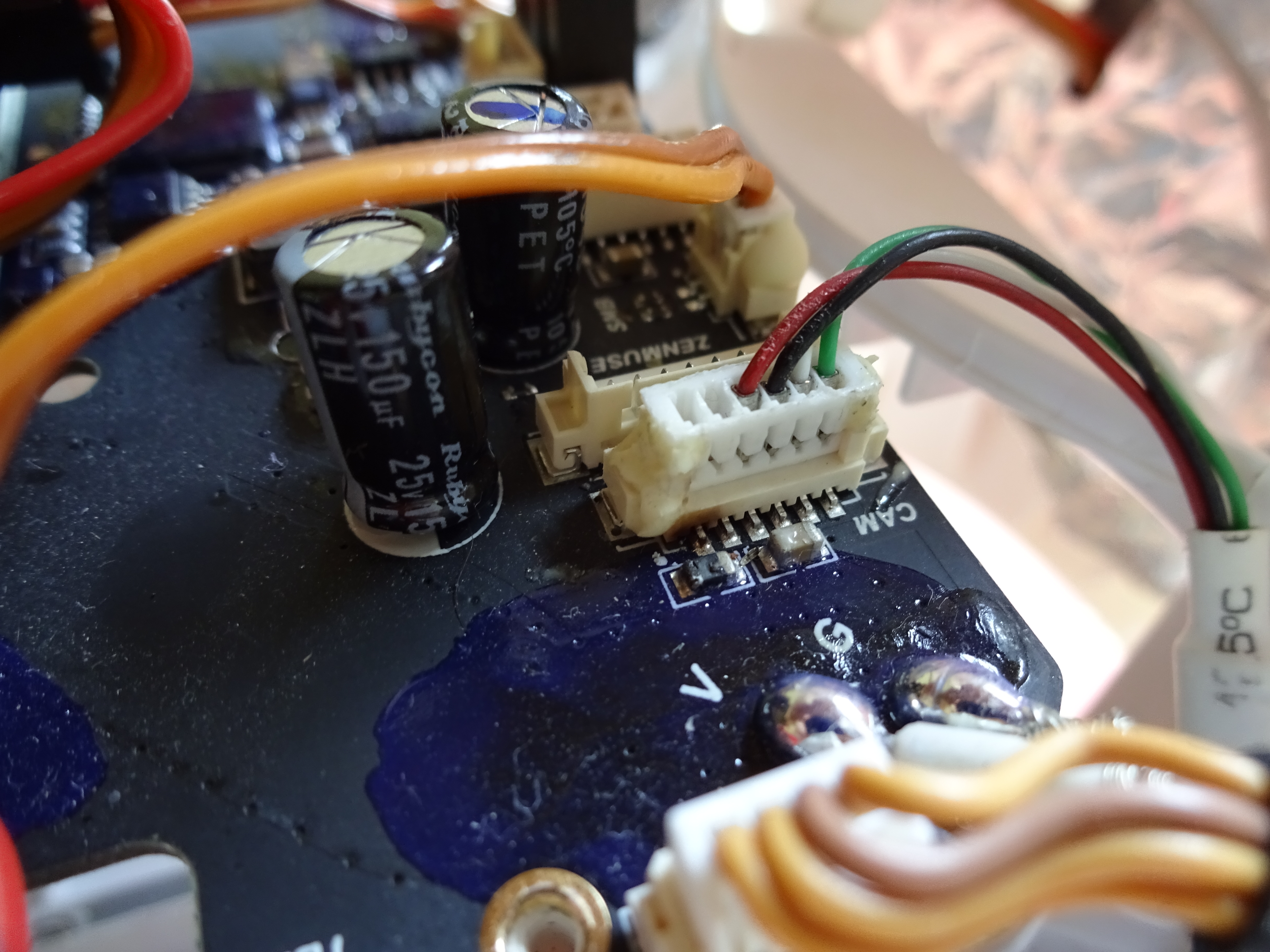

If you tried messing with the wire while phantom was ON, could have burnt the MC?
Here is a picture of a burnt one,
Requires you to open top and look on main controller board right by cam plug, like in picture! If this is the case, you'll need to replace your MC!

My mainboard looks like what you've linked (see my picture). Sometimes i have fpv sometimes not but the recording is ok. You said should be change the MC, but the MC isn't it the black boxy thing?
Thanks in advance!
Hi J Dot!
Thanks in advance!View attachment 24258

Yes it looks burnt, this is caused by either unplugging camera with it powered on, or a short somewhere?
You might have to replace the whole main Controler board, or possibly find an electronics expert to repair your circuit board, you might want to replace the white camera wire as well, it is like $11 U.S. To replace cable, MC IS AROUND $60. Or go into classifieds, maybe one of our awesome members has a wrecked phantom or parts for you cheaper? If not eBay might be a better route!
Sorry that happened to you, but those cameras are touchy when plugged or unplugged with phantom powered ON! Hope this helps!
