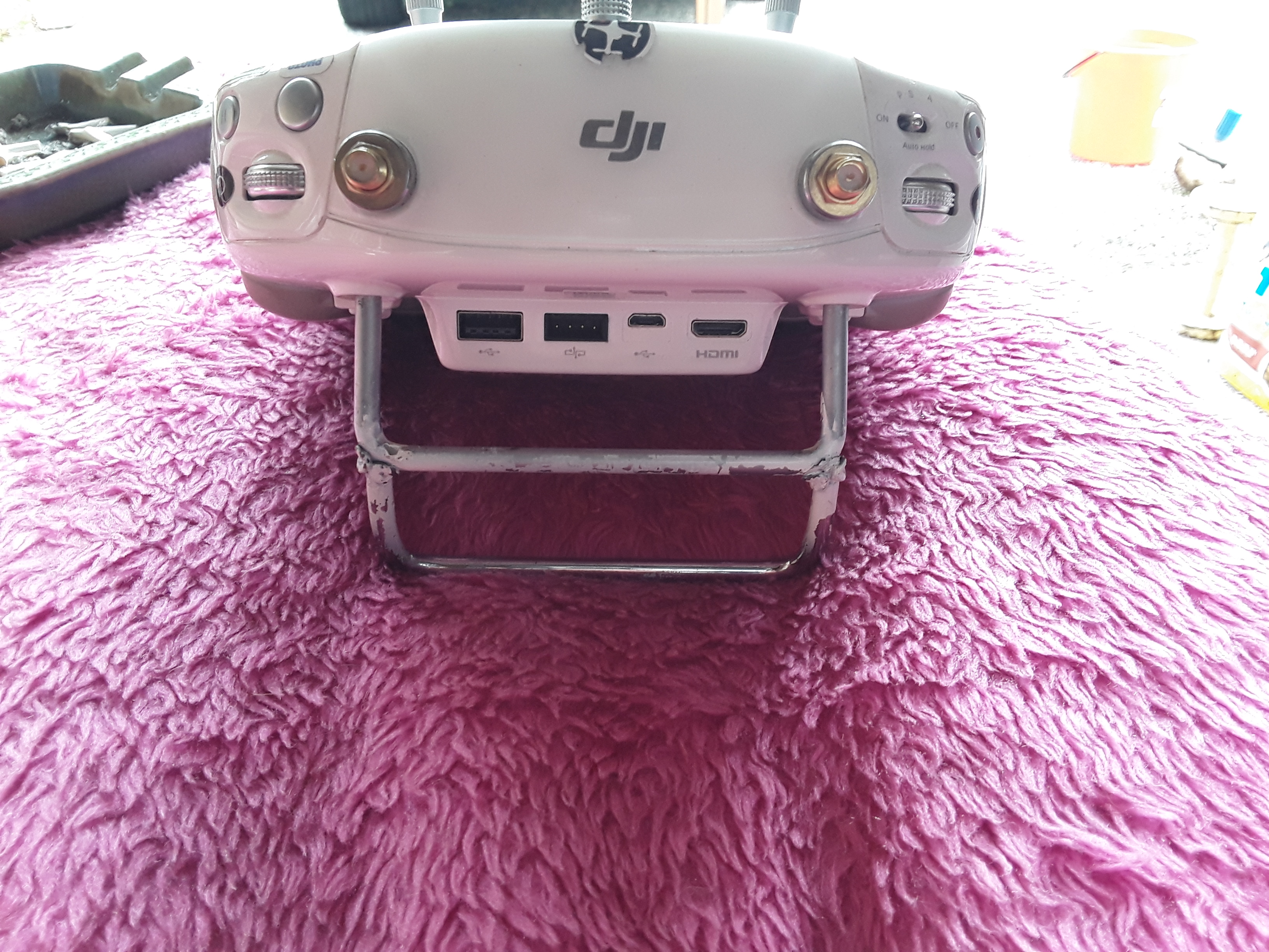

Great Yeh only other way to get batt for remote (original batt)which dji don't sell,,no idea why,,,,is to buy a second hand remote,,but these others from ones as posted above seem to turn up in some remotes so they are being used,,,mate you might even have a 7.2 lipo rc batt off something else that might fit,..cut and re solder plug on and away.....sorry 7.4,,,,if I could ship I would,,just looking at my p4 remote,,,p4 crashed so still have remote,,,aaahhh there's a battery ,,,hey I find out more about shipping batt,,I know it's bit tricky from NZ but I have a good one in my remote
See me got this,,,,if I can ship batt to you I ask you later for details,,I won't know till tommorow at post shop,,,you can have it ,,got some other bits you can have to if needed,,just ask,,I'm living in a shed so don't need some stuff,,,,no charge,,,I just send more stuff to Ireland,,are you around that area looking at your logo
See me got this,,,,if I can ship batt to you I ask you later for details,,I won't know till tommorow at post shop,,,you can have it ,,got some other bits you can have to if needed,,just ask,,I'm living in a shed so don't need some stuff,,,,no chargeView attachment 109438

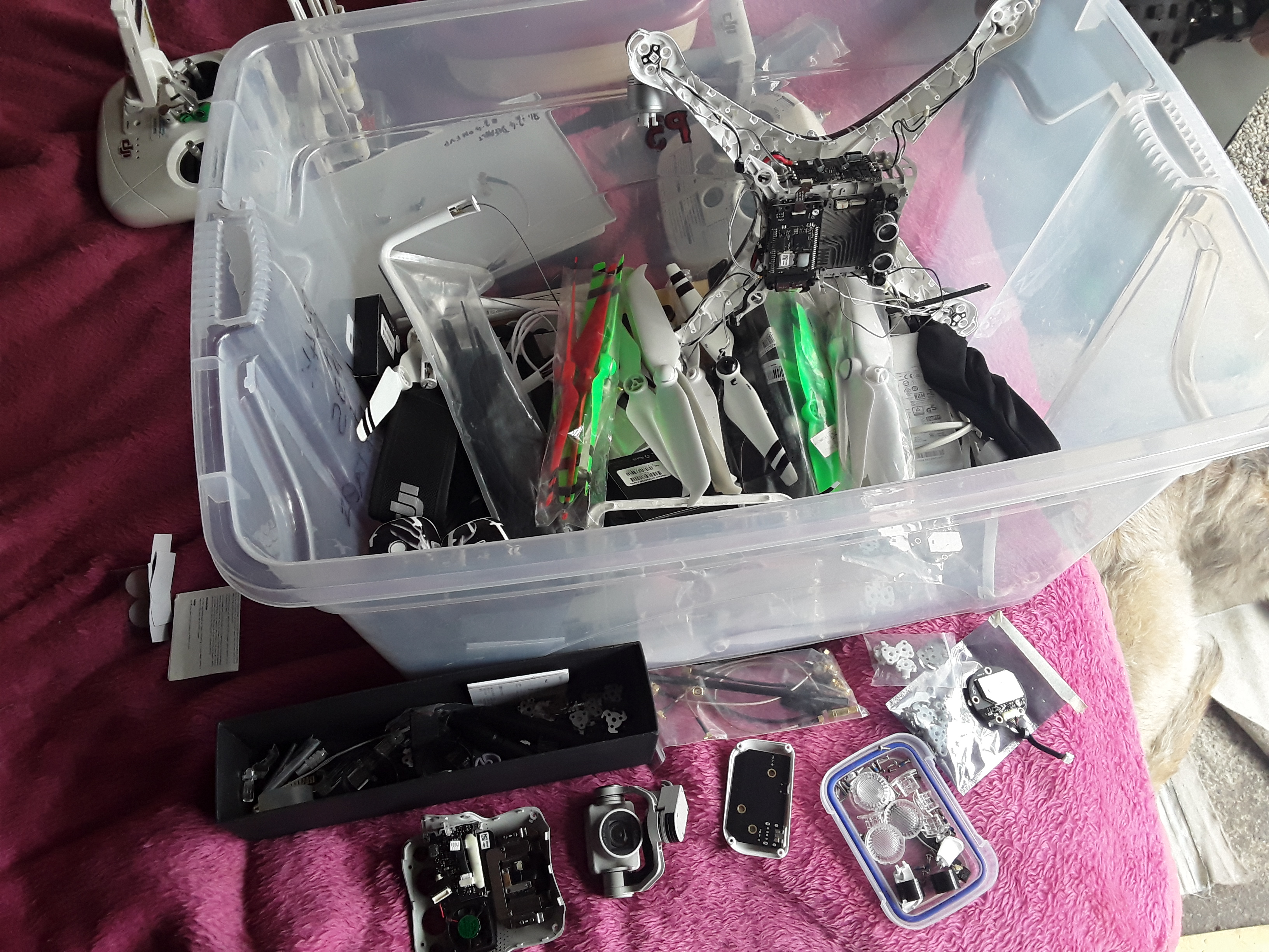

OK got few bito and bobs about,,,me take batt out of remote and try very hard to send,,I won't know till tommorow but mean time I make you a goody box,,there new prop locks ,blades,,cam but gimble snapped off,,I can't remember what in here but I try fit it in a box,,and send,,,this week,,but unsure on how they are with battery's being posted,,I sort it,,no charge just pm your shipping address,,it don't have to be your house if worried about that,,use mates address or similar,,,at least you can use it for spares,,,,as much as I want another,,I'm not in a position to buy yet....got 1 good p4p batt too ,
Reactions: John Bollinger
OK got few bito and bobs about,,,me take batt out of remote and try very hard to send,,I won't know till tommorow but mean time I make you a goody box,,there new prop locks ,blades,,cam but gimble snapped off,,I can't remember what in here but I try fit it in a box,,and send,,,this week,,but unsure on how they are with battery's being posted,,I sort it,,no charge just pm your shipping address,,it don't have to be your house if worried about that,,use mates address or similar,,,at least you can use it for spares,,,,as much as I want another,,I'm not in a position to buy yet....got 1 good p4p batt too ,View attachment 109440
