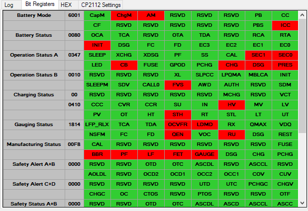

Here is a picture of registers from DJi Battery Killer but I dont think its the registers that are responsible for the LEDs and power button side of the battery.
