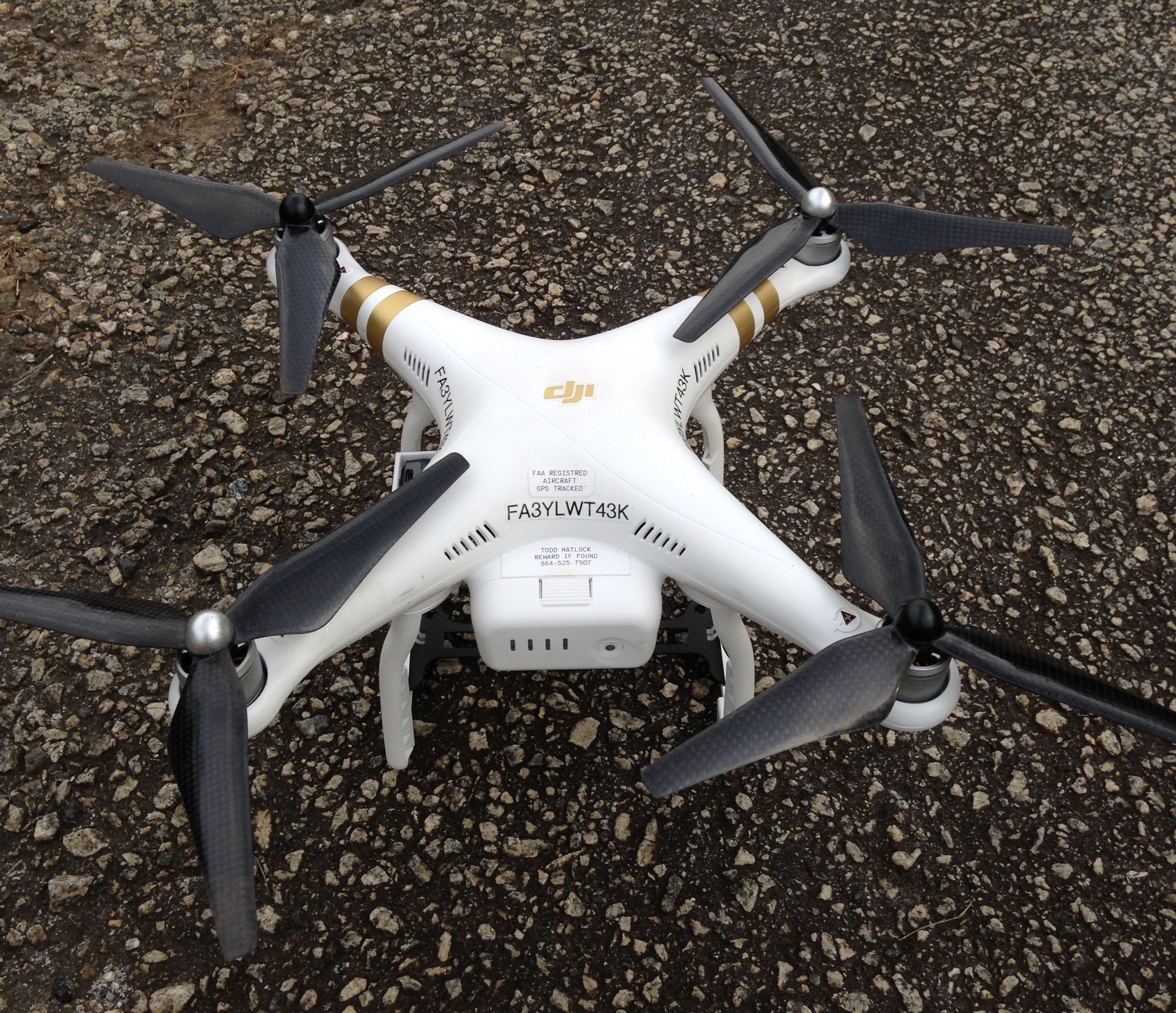

3 blade carbon fiber disaster never again!!
Oh i see what your saying could be
Yeah, I've never had it happen with my Phantom, but with my racing quads I've managed to get props mixed up and that fast flip behavior is exactly what I see when I have props reversed. I wouldn't assume the manufacturing got the props correctly threaded and/or color-coded, but you could visually check that the pitch is going the right way.
*** EDIT *** When I look at your picture, the pitch seems to be going the correct way at the four corners...

I thought it would be fun to goof around with 3 bladed props carbon fiber.Ordered them from China they came today.As soon as i hit the throttle the two front props appeared to have more pitch and it just flipped over and crashed.making this horrible sound like gears stripping out.Should i be concerned about this sound i heard?Any help would be great and yes i have learned my lesson...yes i'm stupid but they do look cool or did lolView attachment 59052
As previously stated take off props and rotate motor adding to that hold the motor up to your ear while you turn in back and forth with your fingers. If you hear any grinding or scratchy sound the motor is toast. Don't run the engine again you can burn out the ESC board. All of these are fairly easy to replace just take your time and be careful with the solder gun. The motors approx $20 and the ESC $20 on a P2V+ not sure on other models. Carbon fiber props are to stiff (no give)....you want a little flex in the props. I hope they had some designation which one turned clockwise Black Post and counterclockwise Silver Post or you will flip it for sure.
Popping on some random props because they look badass isn't going to improve the performance at all.
If it was that simple, DJI would have done it already.
These 3-blades should have worked fine... not as the stock props, but they should have worked.
It sounds to me (pardon me op) that the props were not on the correct motors?

Except, as has been previously noted, there must be 100 threads on this subject with the same outcome - typically a crash or at best poor performance. While it may well be possible to design a three blade prop for the Phantom, it isn't at all clear that the Chinese guy with an injection molding machine did any sort of analysis other than copying a design that looked cool.

All looks as it should in your pic, correct prop placement and they look similar enough.
If some props are producing more lift than the others, it shouldn't be too much for the on-board flight stabilizing systems (detecting unwanted roll) to compensate for. It seems it has failed to do its job in this case.
well my 3-blade props turned up yesterday, had a few batteries charged & good weather today so went & gave them a try. My first major crash, the Phantom couldn't seem to stop it climbing & couldn't stop it shooting into a tree. Props are knackered (no loss) & flew over 8miles with the DJI carbons on afterwards
