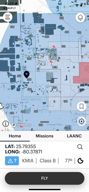

Download the B4UFLY app and put that location in the app using the Search (magnifying glass icon) it will let you know if you need to get LAANC clearance. The 5 mile rule went out the end of 2018.

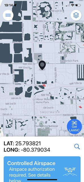

Here is screen shot from B4UFLY
Another from Air Control where you can apply for LAANC clearance

You need to have a Laanc app. If you do, you can just go to the mission site and it will tell you and let you get authorization on the spot.
You also need to check the site on the DJI fly safe website you may need something from them to
