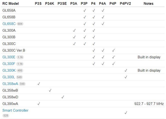

is it possible to used the same Remote Control
Here's a remote controller compatibility chart:

the answer to the remote question is no. The P4 Standard uses the Gl300 A or B or C. The P4P uses the GL300F. The Gl300F will work on the P4S but the Gl300 A will not work on the P4P
