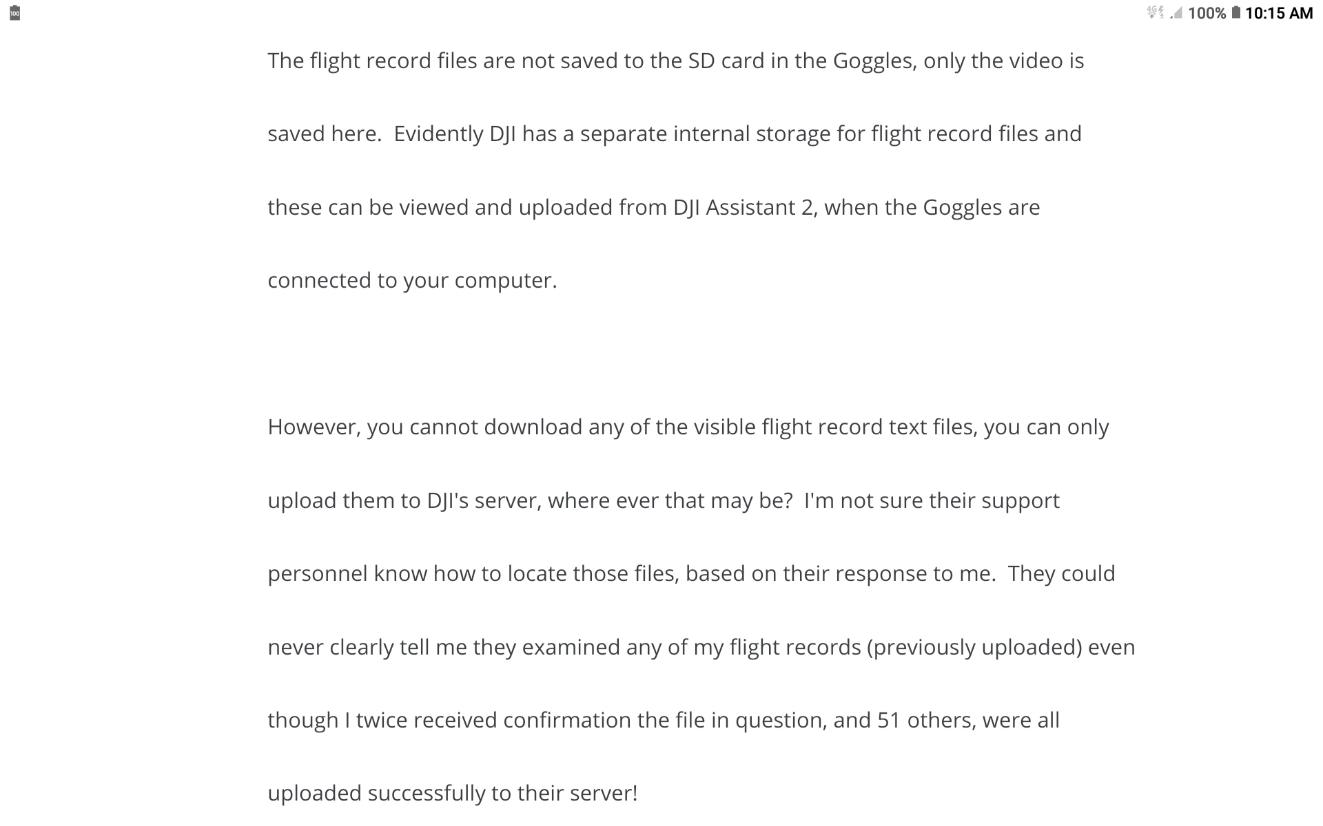

Has anyone found a way to get the flight data off the DJI goggles without tech support? I was able to get the data uploaded to DJI's server with a version of DJI Assist 2, but the files don't show up in DJI Go 4. They are there, I am frustrated that I need to go through tech support to get the data off my goggles.

How am I supposed to upload the data if DJI won't provide access? It's sitting on their server somewhere but tech support is not getting back to me.

Also, they've indicated that the Flight Records that were stored in the DJI Goggles don't support syncing with the DJI Go 4 App and it was only used to data analysis. If your aircraft is still within the warranty period, we can perform a covered Data Analysis Service for the flight records of your aircraft and get further information regarding the incident. However, if your unit is already beyond its warranty period and you'd like to conduct Data Analysis, there will be a corresponding fee of $65 but it will not affect the warranty period of your aircraft.
