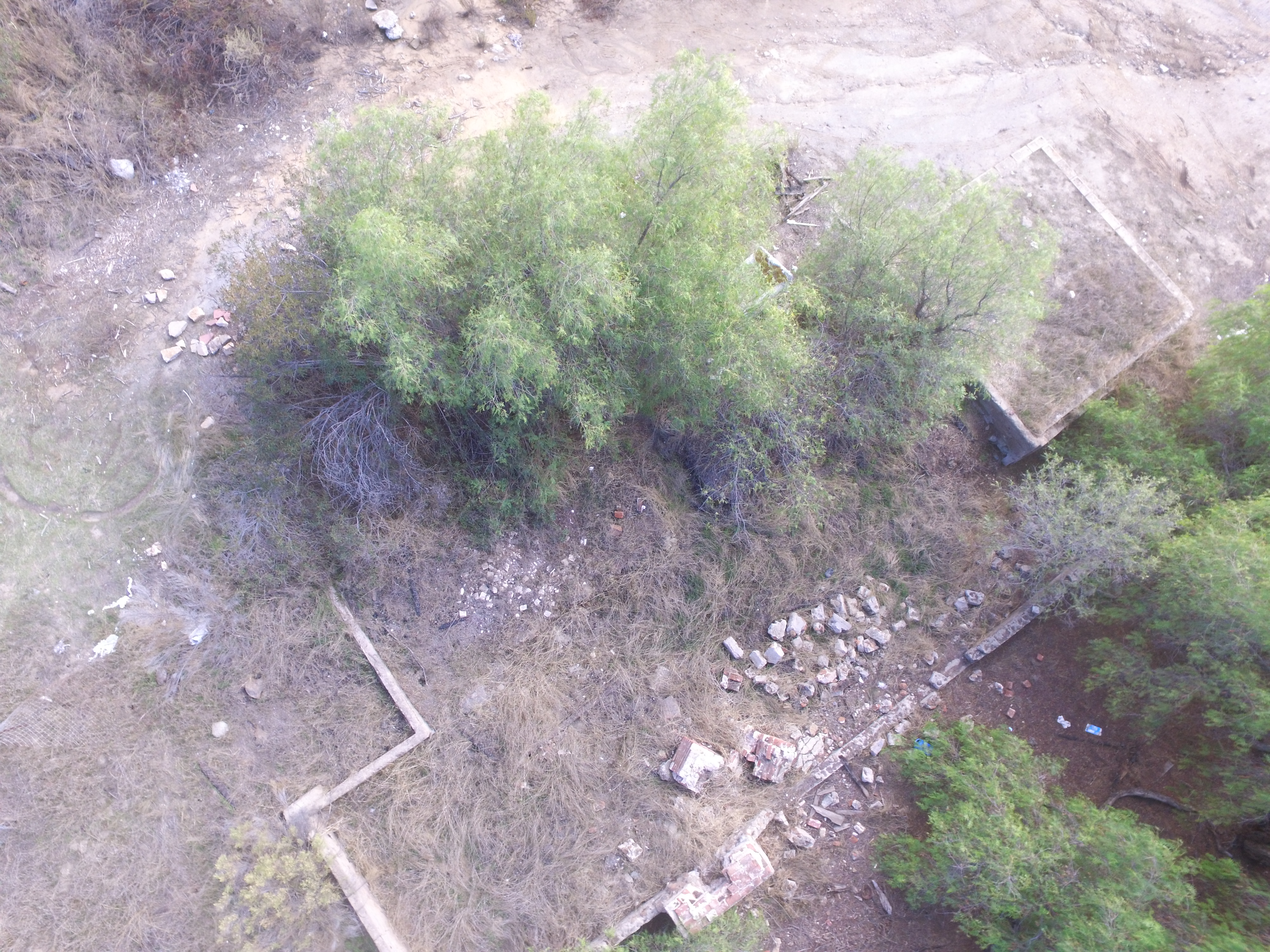

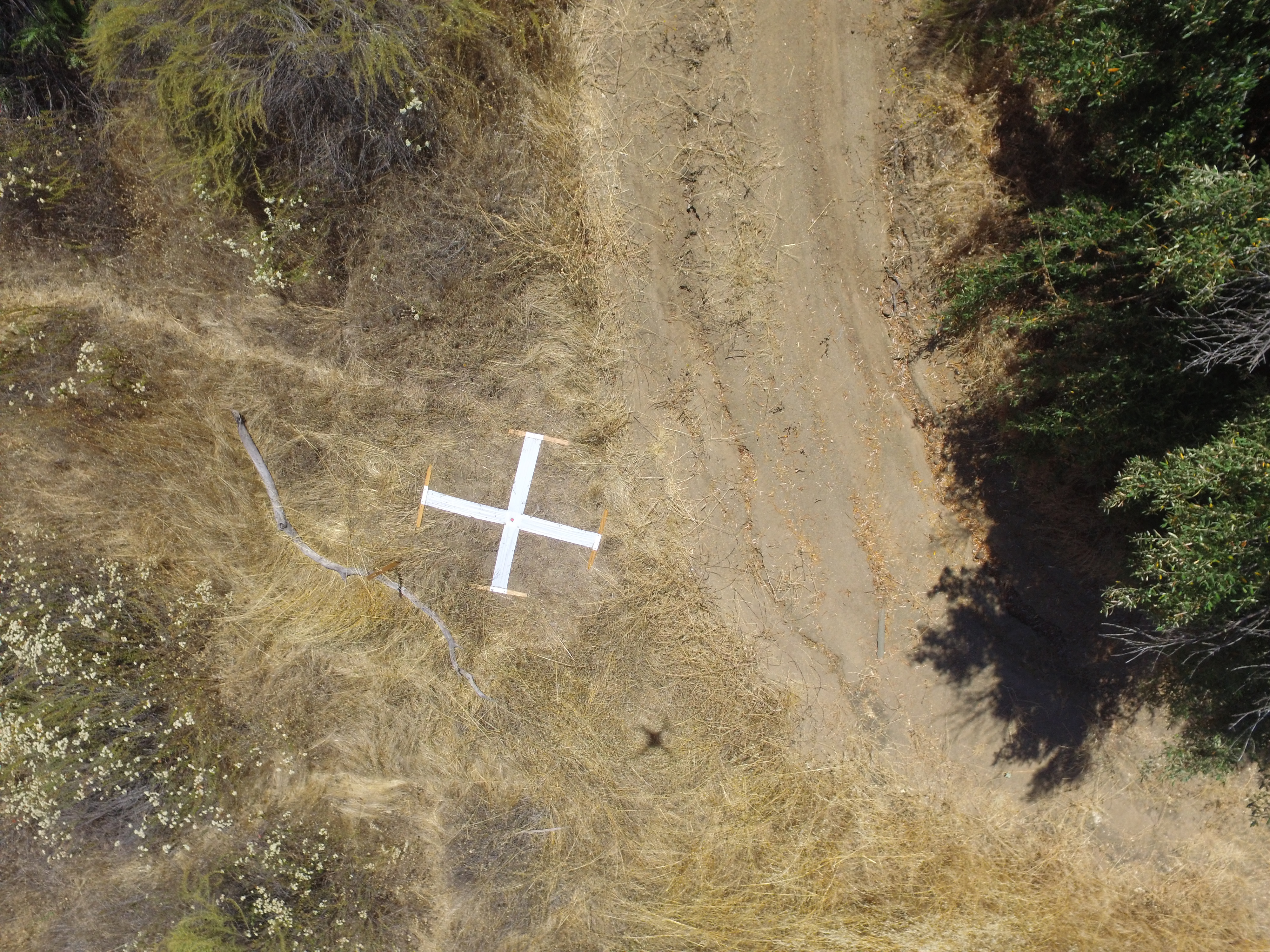

I found a old homestead possibly dating back to the 1800s, with no visible land access beside a rugged hike in. So I'm trying to fully explore the site by air,. One out building possibly a barn is downslope on the opposite side of the mountain. If I drop down for a closer look I will most likely lose control signal. In another site, I think BLM land about a mile to the south I found what I think is a air marker. I don't know if its a research marker, immigrant direction sign or narco drop site. I want to explore that closer but dropping down again would likely put me in RTH control and the only chance to save the P3s if the control signal is lost. Thanks for the help Ill test and train so I can rely on RTH when needed.

I found an old homestead possibly dating back to the 1800s, with no visible land access beside a rugged hike in. So I'm trying to fully explore the site by air,. One out building possibly a barn is downslope on the opposite side of the mountain. If I drop down for a closer look I will most likely lose control signal. In another site, I think BLM land about a mile to the south I found what I think is an air marker. I don't know if its a research marker, immigrant direction sign or narco drop site. I want to explore that closer but dropping down again would likely put me in RTH control and the only chance to save the P3s if the control signal is lost. Thanks for the help Ill test and train so I can rely on RTH when needed.
It is a surveyed ground control point for aerial mapping.
There will be others around, put probably miles apart.
