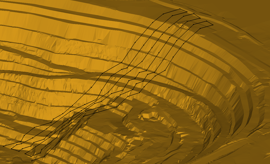

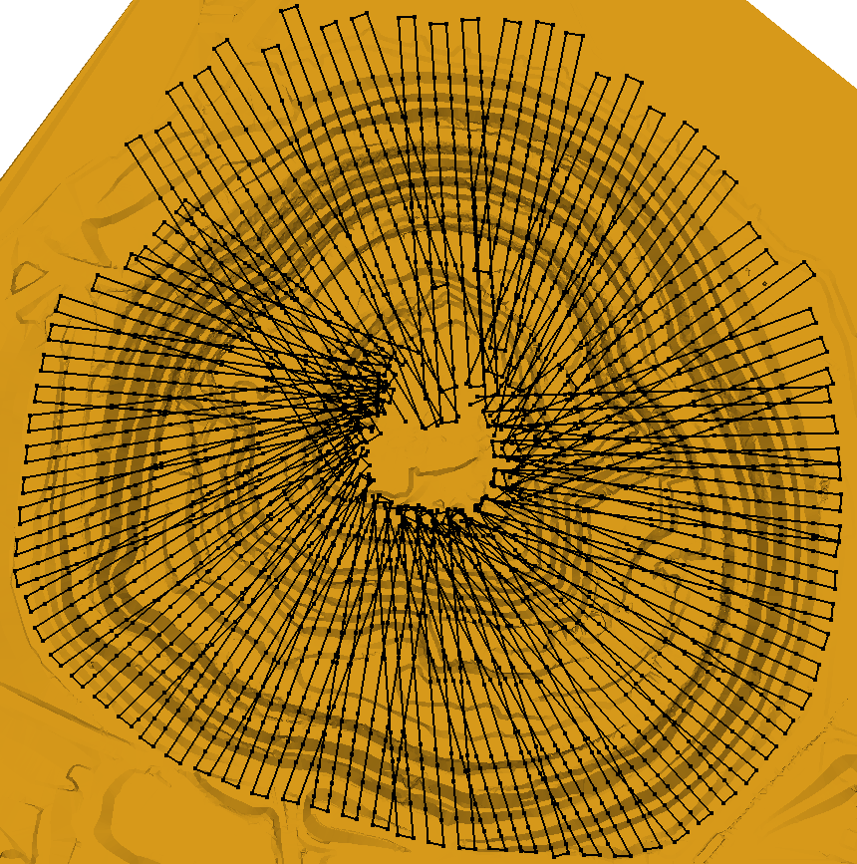

I do not know if there are specialists in geology here, but I will describe the problems in detail. For clarity, I will add pictures.
You need to shoot a quarry with DJ Phantom 4 Pro. The route runs from bottom to top with additional points. At approximately the same height on each ledge. I draw the route in the Micromine geological program. Each point has coordinates in the VGS84 system. When importing to MissionHub. the route is drawn off the coast of Guinea. Although I myself am in Kazakhstan. I am trying to use Litchi.
Please, could you help me with the solution of the problem? Or guide me on the right path?
I know that this shooting was carried out on the model of DJI phantom pro.
Thank you in advance.

In whatever app you end up using, you should NOT go up and down on each leg of the mission. Rather, you should fly legs at a constant altitude and then on the next leg, make the elevation change.
Reactions: Jeko0111

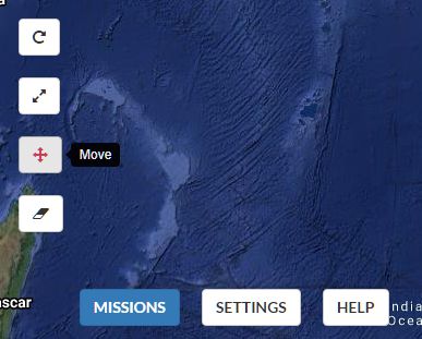

In Mission Hub you can move an entire mission by activating the 'MOVE' button.
