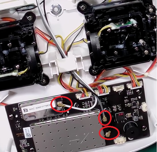

Hi, I just modded my controller with the Argtek range extender antennae and I've run into problems. There seems to be very little signal coming from the controller and my video feed and range are greatly reduced. I've gone back into the controller and checked connections, swopped around wiring and antennae but nothing has worked. I bought the mod from amazon.com and I'm pretty confident that it's a genuine blue proton product. I believe that the long antenna included in the mod are 10 dbi which from what I've read should be powerful enough to do the job, it's almost like there's very little signal being transferred in and out of the controller. Could anybody suggest a test that can be done to assess the signals going to and from the controller? To compound things, I managed to damage the original antenna taking it out so I can't even revert to my original setup. I have been trying to source a replacement P3 antenna, from what I understand any P3 antenna will do? I have found it very difficult to source replacement parts for the P3 SE, maybe in other parts of the world it's easier but in ireland the dji store won't ship to here and there are very few replacement parts available on ebay etc. I have been in contact with dji support but that means shipping the controller to the Netherlands for repair when all I need is a replacement antenna which I can install myself. I'm fairly new to this so any info or advice would be much appreciated. Many thanks

I have read that there are some copies of the Argtek antennas and they don't work, not sure about how you go about identifying the fake ones, i do no that out of the three leads that come from the bar to hold the antenna's were not the same as the ones i saw in the video the white wire on my Antenna was actually grey, not sure if that identifies the fake from original antenna, but there are loads of postings on forums stating they are actually worse than stock antenna, then there are postings that people have seen a vast difference in range, one thing to make sure is that the connectors are inserted properly and that the pins in the center of the connectors are not bent over they are very fragile, check your connections give the wires a gentle tug to make sure they are snapped in all the way home
Yeah there are differences in wire colour between the stock and the mod but also between the different phantom models - i have the se and the mod has a white wire going to the middle antenna wheras i think the argtek mod for the P3 standard has a grey wire in the middle antenna position. I like the idea of placing the antennae outside the controller and allowing someone to put whatever antennae they want onto it. There can't be many reasons why the argtek mod doesn't work, i'm open to correction but it seems to me that it can only be down to a few reasons, dodgy antennae or dodgy wiring/connections and there must be a way to test and eliminate these reasons to find out where the problem lies - any techie people out there with an opinion on that?
You're right about the connections inside the controller, they're tiny and i was worried about damaging the pins but i've gone back in a few times and i'm pretty sure that the male connections attached to the board are ok, i'd be more worried about the connectors at the end of the argtek wiring, it's hard to see what's going on inside those.
When removing my original stock antenna i managed to pull the connector off the end of the wire - anybody have any suggestions how i might reconnect that or maybe connect a coaxial cable/connector to it to allow me to plug it into one of the inputs on the argtek bracket?

you can always check the cables for continuity and make sure they are all ok and also check for any shorts across the cables, i see your in Ireland same as myself
That's great, I have a multimeter I'll check that out. I had the drone out today and I'm finding the best setup on the Argtek is when I use all 3 omni directional antennae, the flat antennae aren't really working for me no matter how I use them. Yes, I'm in Clare :) Regards

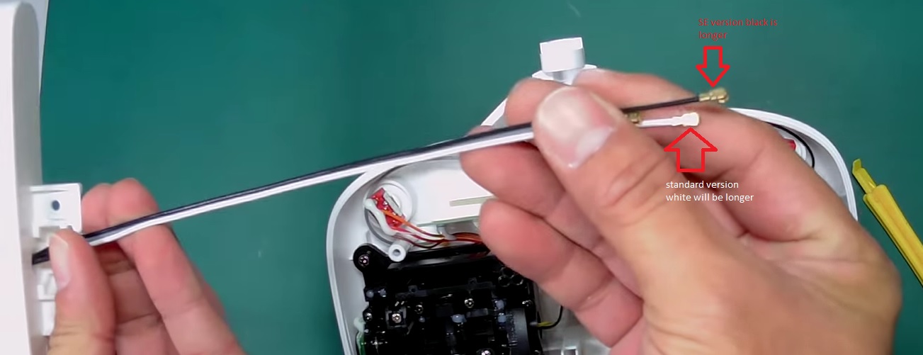

did you make sure you had the SE version of the antenna and not the standard? SE version the black cable is longer and the white cable is longer for the standard version.
