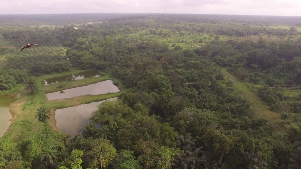

I just successfully completed my longest Litchi Mission thus far. Started out with 98% battery, and the flight time for this 5.8 mile round trip was estimated by the Litchi Mission Hub, at 26 minutes. The altitude ranged from 150 feet over the forest, and climbed to 246 feet over the town, so I could scan for cellphone towers, and mark them on the Mission Hub map.
The drone soared back into view at the 22-minute mark, and when I landed it, the battery level stood at 22%, with the battery icon colored an ominous red, while the Litchi lady's voice prompts issued one dire battery warning after another. The recorded 2.7K footage took up 3.85 GB on the memory card, and there were no close calls to speak of during the entire flight.
Looking at the 22% battery level on landing after this 22- minute flight, I decided to ensure that all future flights do not exceed this 5.8 mile distance, on calm days like today, and no more than 5.6 miles if there is any appreciable wind blowing in the area. All in all it was a successful test, and my next flight along this course will be at a lower altitude, now that I have mapped out the pair of cellphone masts that lurk along the route.
