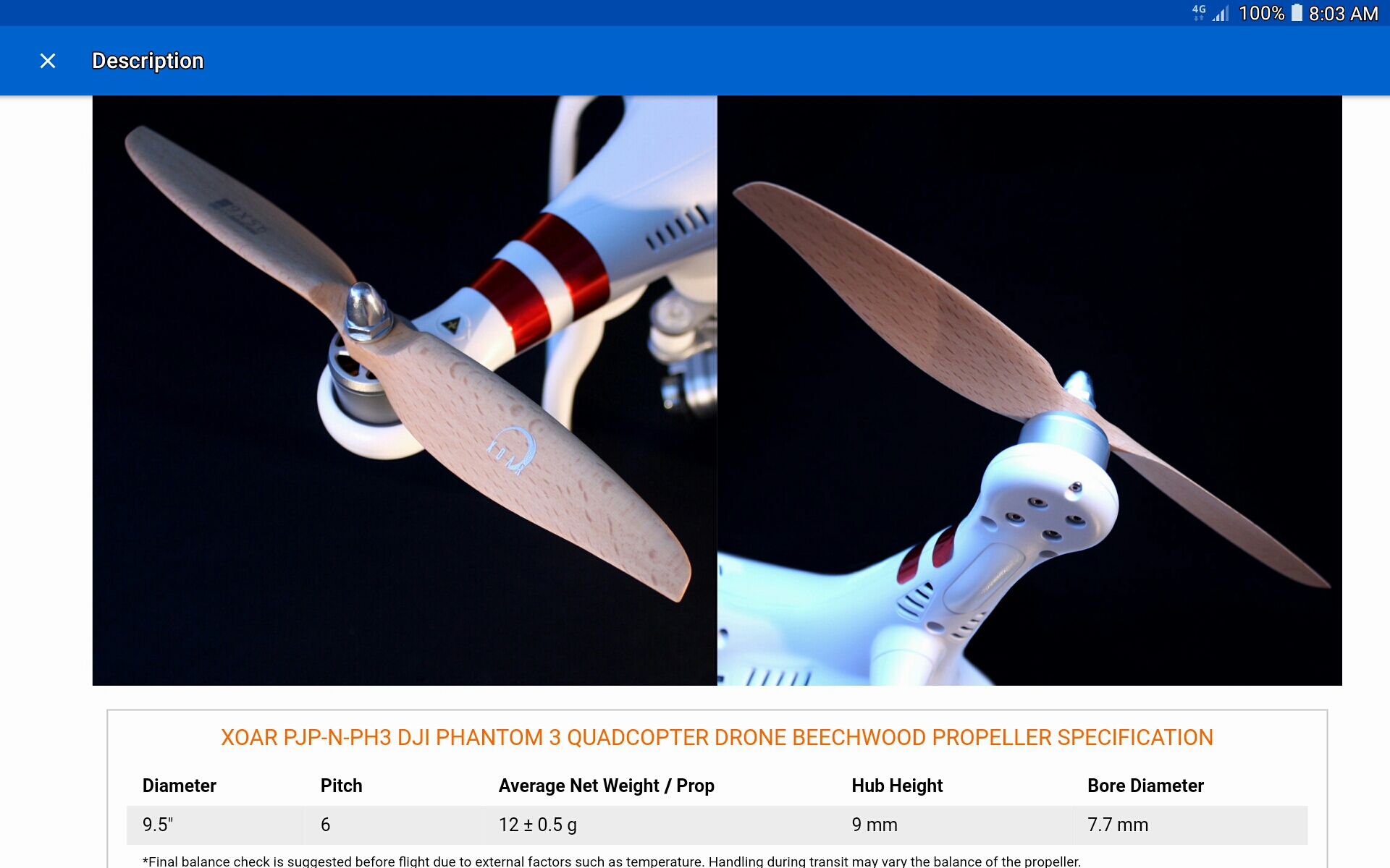

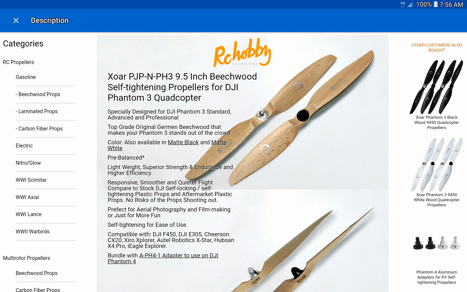

If you use this pasta together with the German beech wood propellers, you will undoubtedly fly faster.

I have seriously looked at these propellers but still have some doubts. Propellers of beech wood are more sensitive to dents (for example by insects) and the humidity of the environment.
This means that these propellers must be conditioned better than the drone. I think it would be an improvement if propellers are made of aluminum.

Except, that statement is wrong in two ways: 1. this is an aerial photography drone, not a performance drone. If you're willing to spend $60, you could put that money toward a performance drone. The Traxxas Aton will do flips and 60+ mph, and you can buy a used one for $200. A much better investment than $60 that does nothing. Why nothing? Because: 2. More importantly, these drones are not even close to limited by the props. They are limited by DJI's programming, meaning that even if the stock props do have some limitations due to the intrinsic flex, you're never going to see the theoretical difference because you'll still have identical horizontal and vertical rates. In fact, if these weigh more than stock, you will actually only have the negative benefits of wooden props: decreased battery life.
So, you're throwing away money for benefits you will never see. There's no, "Well, according to this theoretical aspect..." Nope, doesn't apply when your primary limitation is software-based speed control.
