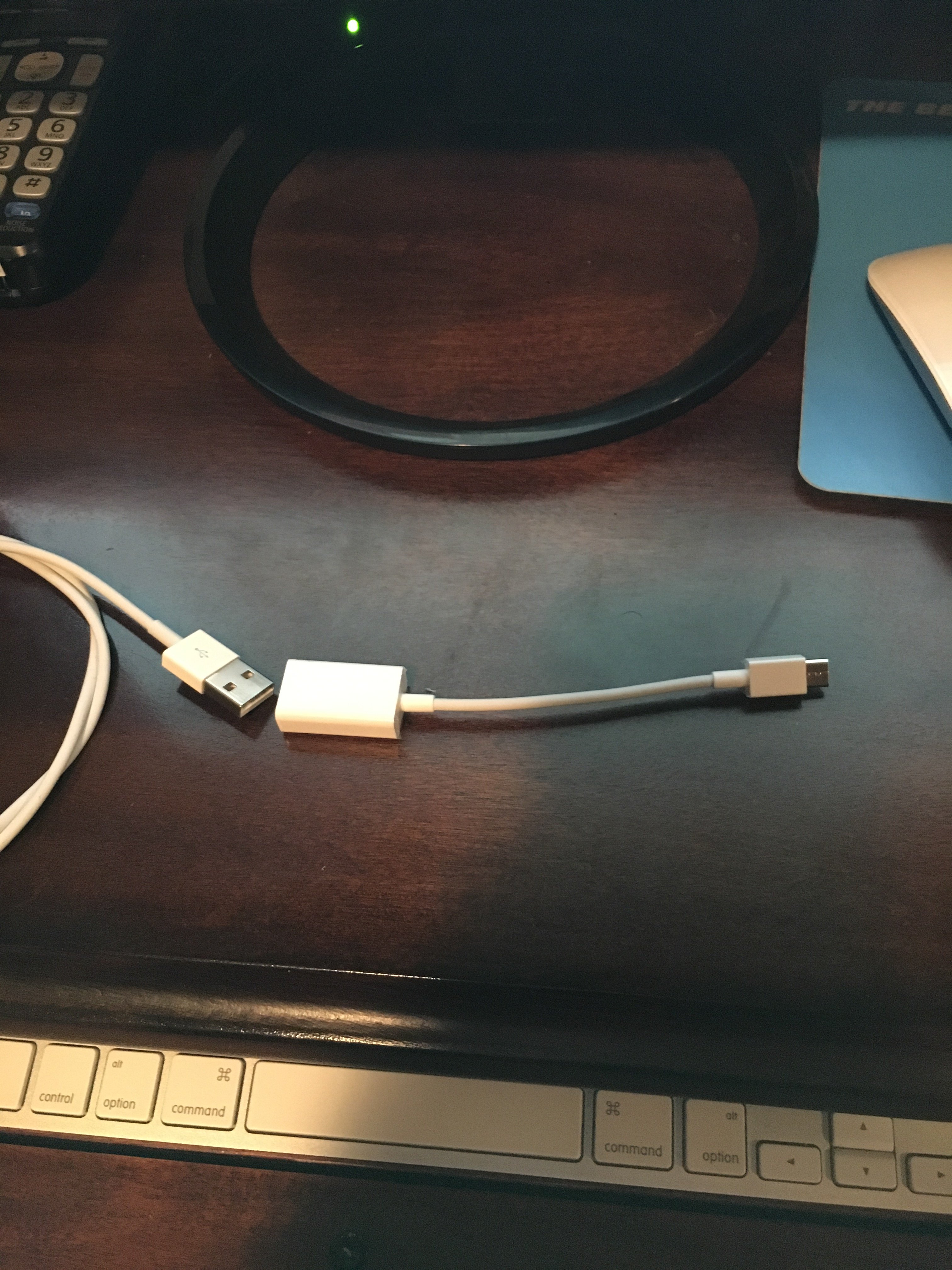

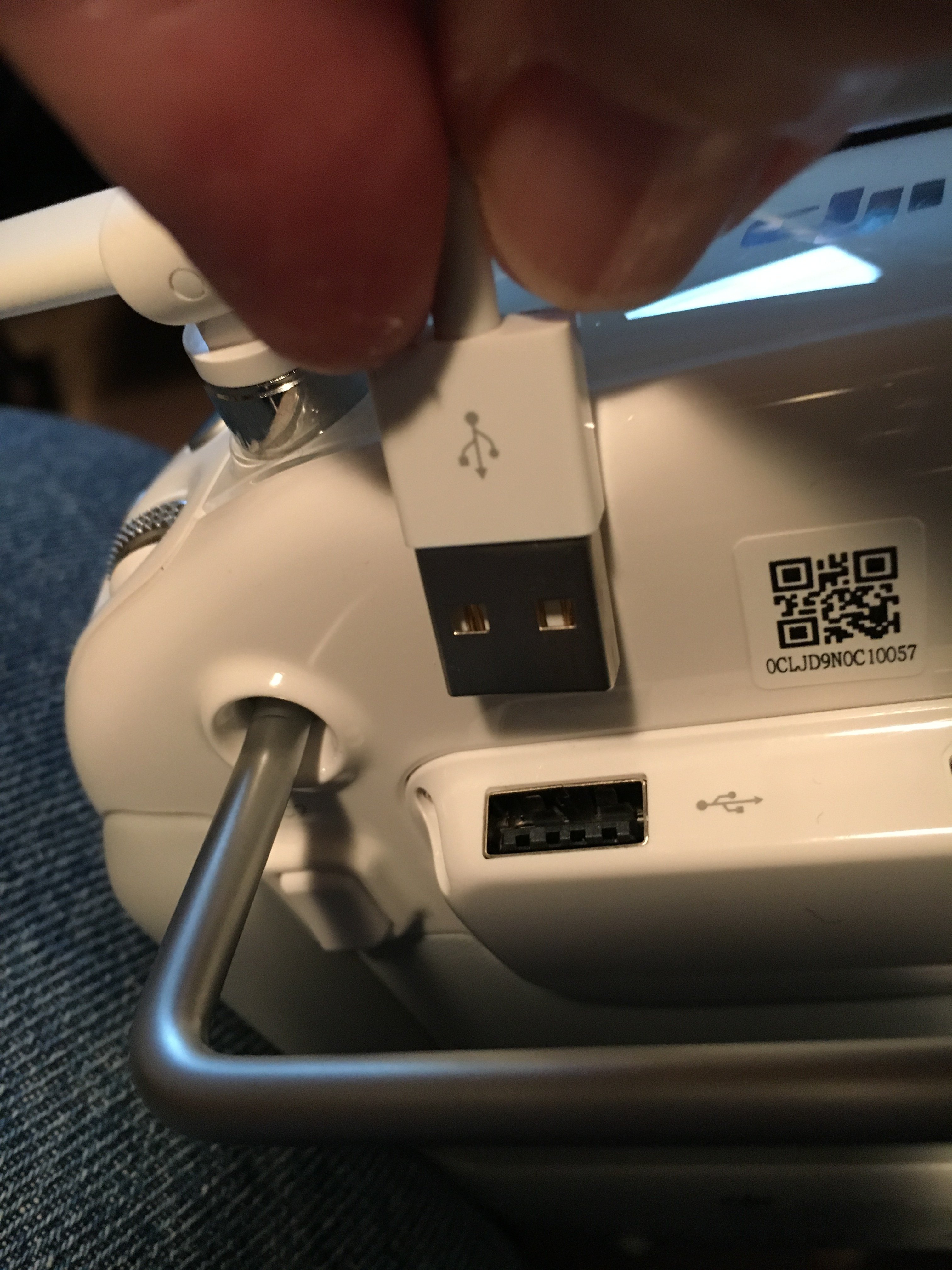

For the new folks (myself included) some tips:

4. If you have an iOS device, then you are probably using a USB to Lightning connector to charge your tablet. That is the cord that connects the iPad to the RC. Be sure to use the full size female USB port on the RC (#16 on page 10 of the User Manual) See attached photo 1966. Do NOT use the micro USB female port.
5. After the RC upgrade is complete, then you can connect the tablet to the Drone. This is where that curious short cable that is in the box is used. See attached photo 1967. This acts like a conversion USB to micro USB, and plugs into the side of the Drone, next to the memory card slot. Do not use this to plug into the micro USB port on the RC!
