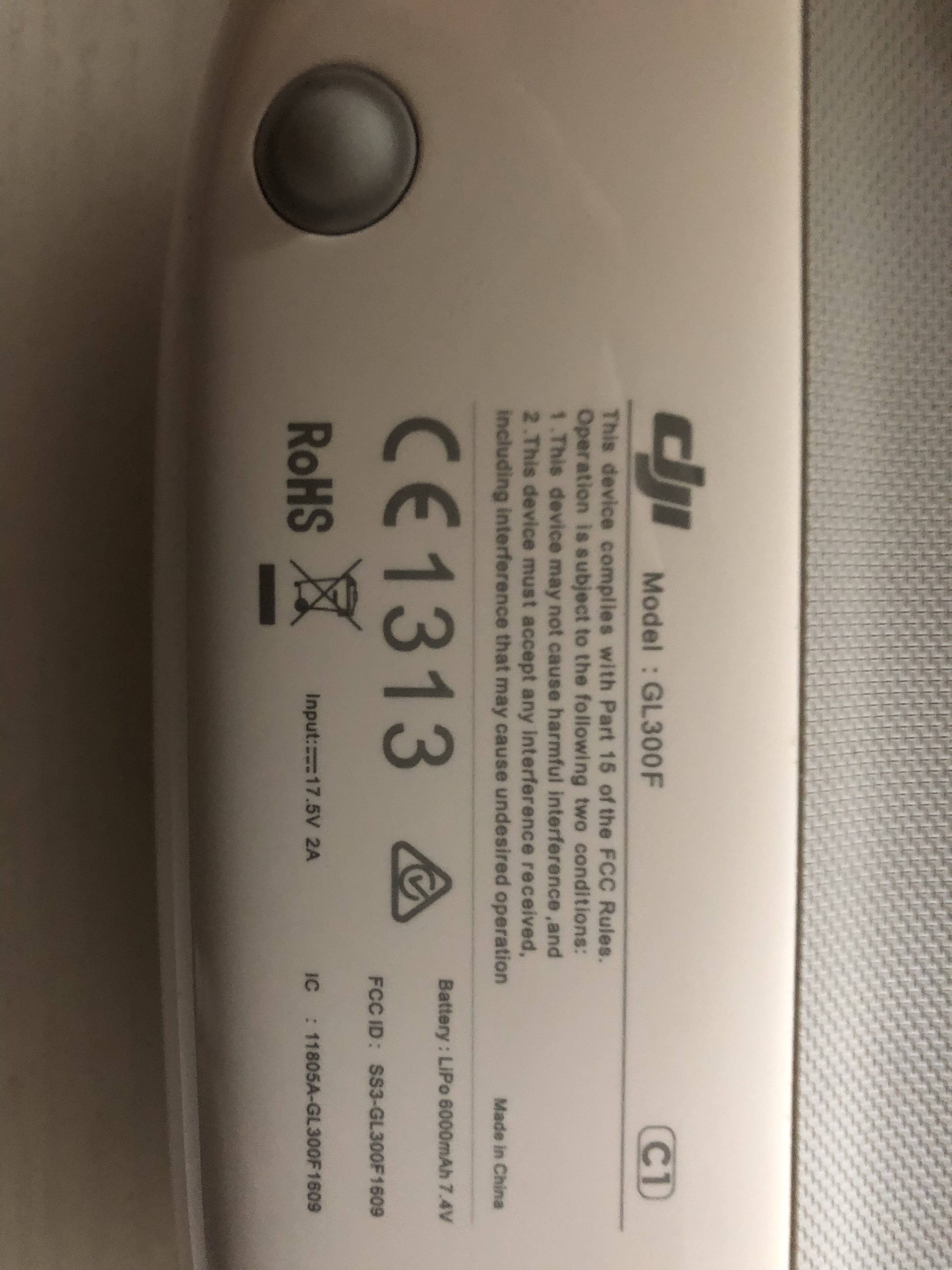

Sorry I cannot get a better picture, but there’s this on the back of my RC
Sorry I cannot get a better picture, but there’s this on the back of my RCView attachment 99085
That doesn't mean what you think it means - it is simply a labeling requirement of 47 CFR 15.19 (a) (3) for RF devices subject to certification.
