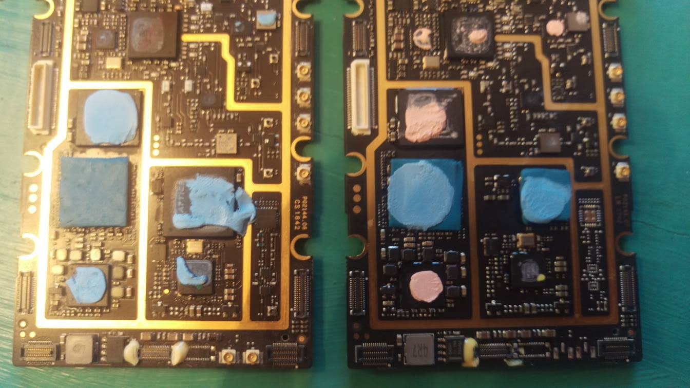

Not 100% certain but at least in my case some Obsidians do not have sub G antenna IPEX connectors on their 3-in-1 main boards and obviously do not have internal (non leg) sub G antennas like white p4ps. The real question to me is what difference does that make for functionality, battery flight duration, signal differences, etc.

Look at the photo, left photo--> p4p 3-in-1 board with a extra pair of IPEX connectors (bottom right) in addition to the 2 pairs of leg antenna IPEX connectors. Right photo --> 3-in-1 board without the extra pair of IPEX connectors (look at the bottom right of each board). Picture is worth a million words...
In the little bit of picture viewing research I did, I'm thinking one of the boards is either aftermarket, or out of an advance or standard? Not unique to obsidian.

One was out of a Ph4 pro and the other was out of an Obsidian. Now what is really interesting is the result of swapping the Obsidian board into my guinea pig ph4 pro. After realizing I had a bad camera ribbon cable the obsidian board (that is short 2 of the six IPEX 3-in-1 board connectors) can be used in a regular Ph4 pro apparently with both Sub G antennas disconnected. I have not noticed any changes in signal transmission strength, range and if anything it seems to have a more stable and greater range for both video signal and RC connection... now go figure?
Don’t want to spend too much time on this but one of those links above shows an aftermarket board for either the white or obsidian P4P. Guessing you didn’t buy these new and one of them has that board in it. Maybe forward your difference questions to a tech at DJI and let us know the results. That would be really interesting
