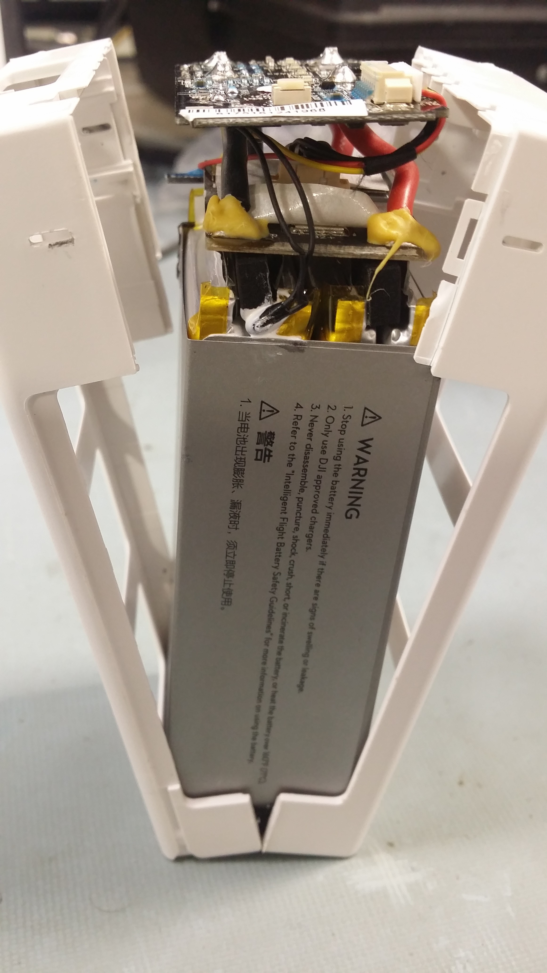

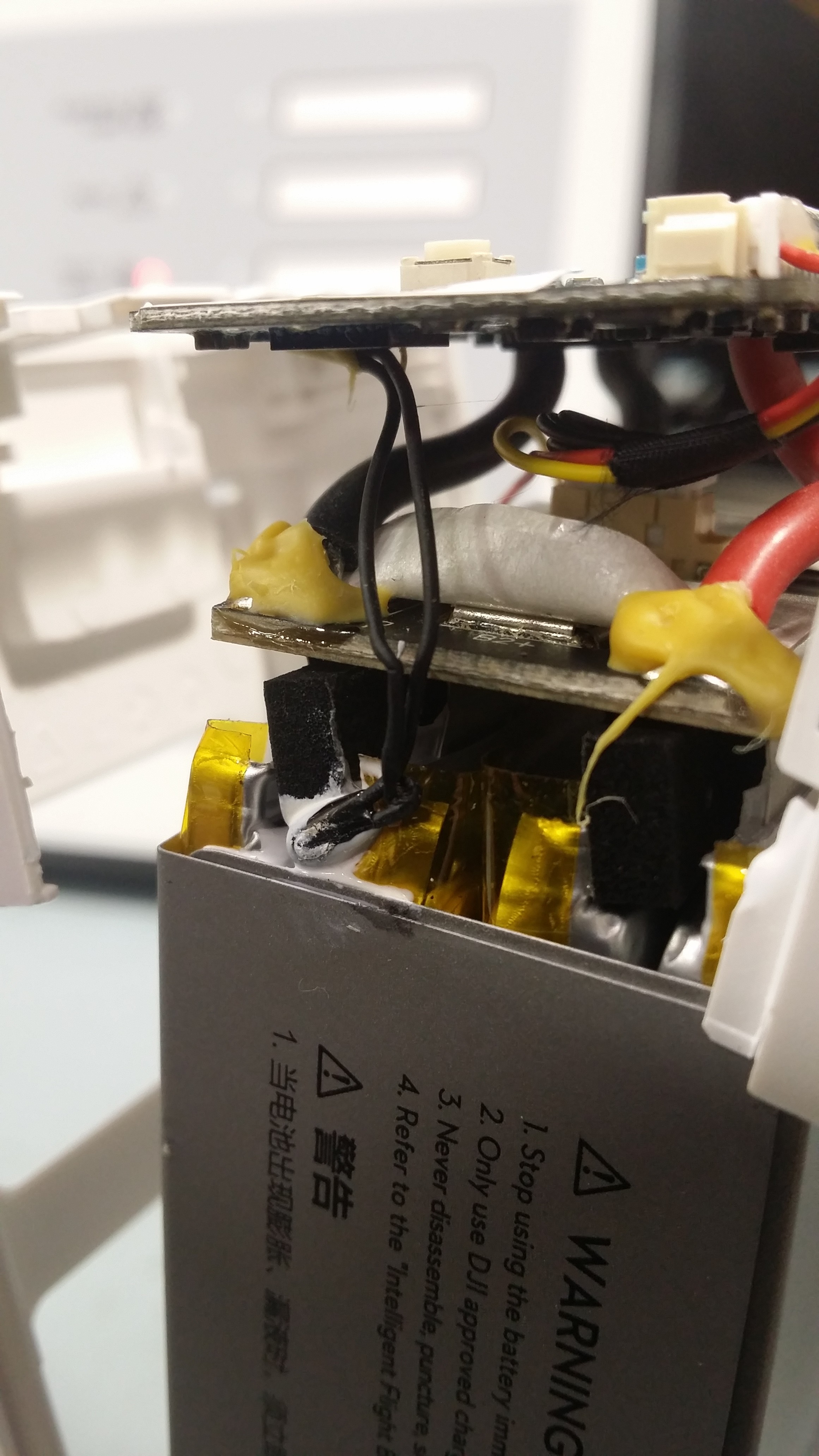

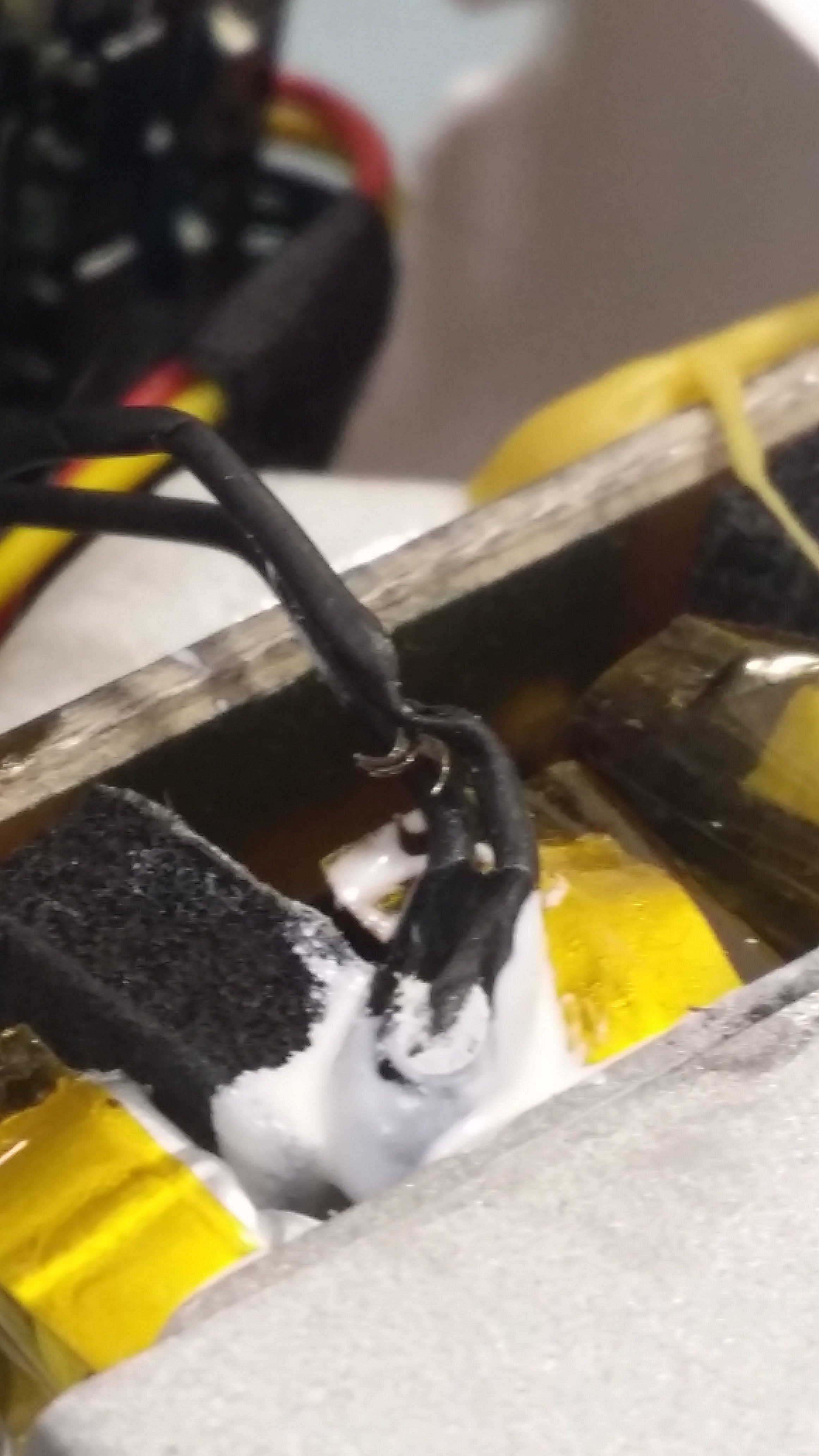

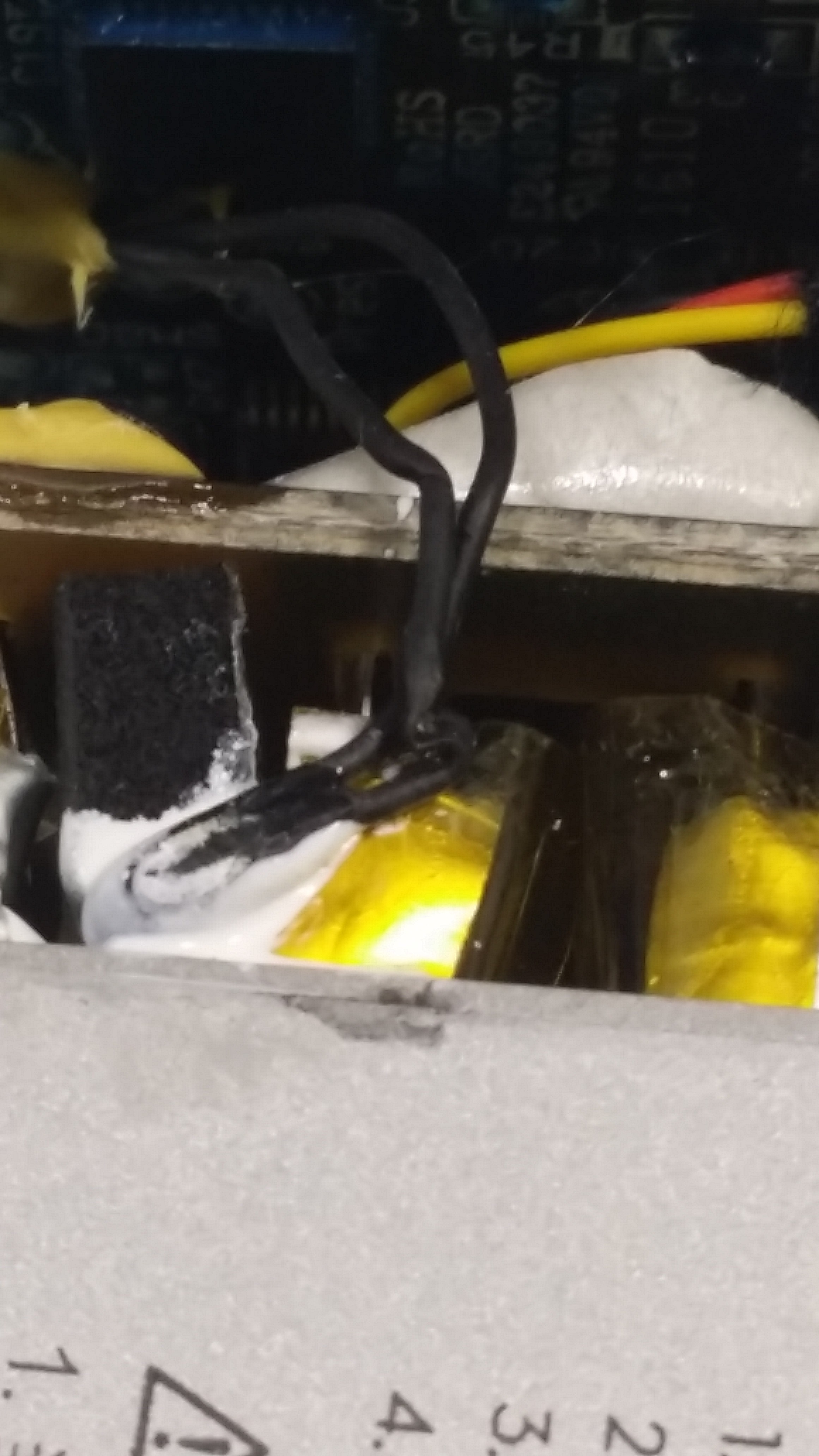

Sorry guys. I'm not a very good contributor. I never did make a follow-up post. Here's the rest of the story:
The Amazon seller from whom I bought the battery that failed refunded my money without requiring return of the battery, so I had the opportunity to disassemble it for a post-mortem. What I found is that the wires connecting the temp sensor to the circuit board had obviously been pinched between the case halves during assembly, and we're intermittently losing contact due to vibration during operation. I was able to strip the wire slightly, repair the break with solder, and reseal with shrink tubing. The repaired battery works great. I have had zero trouble with it since. Hope this helps.
I took a couple of pictures of the damaged wire, but the quality isn't great. I'll post them anyway.
View attachment 77051 View attachment 77052 View attachment 77053 View attachment 77055
