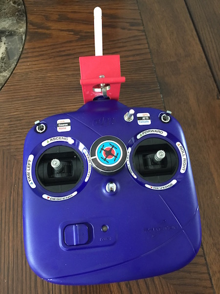

On the props it does... if you want to do the TX & shell like I did those parts require "poly dye". Again sold next to the regular clothing dye in craft shops and walmarts. Regular dye is fine indoors, poly dye is not, only use it outside. Do a search here and you will find a plethora of threads on this topic.
Phantom 2 Zen TX dyed blue. :)
Is the " poly dye" the synthetic stuff, also sold by RIT?
