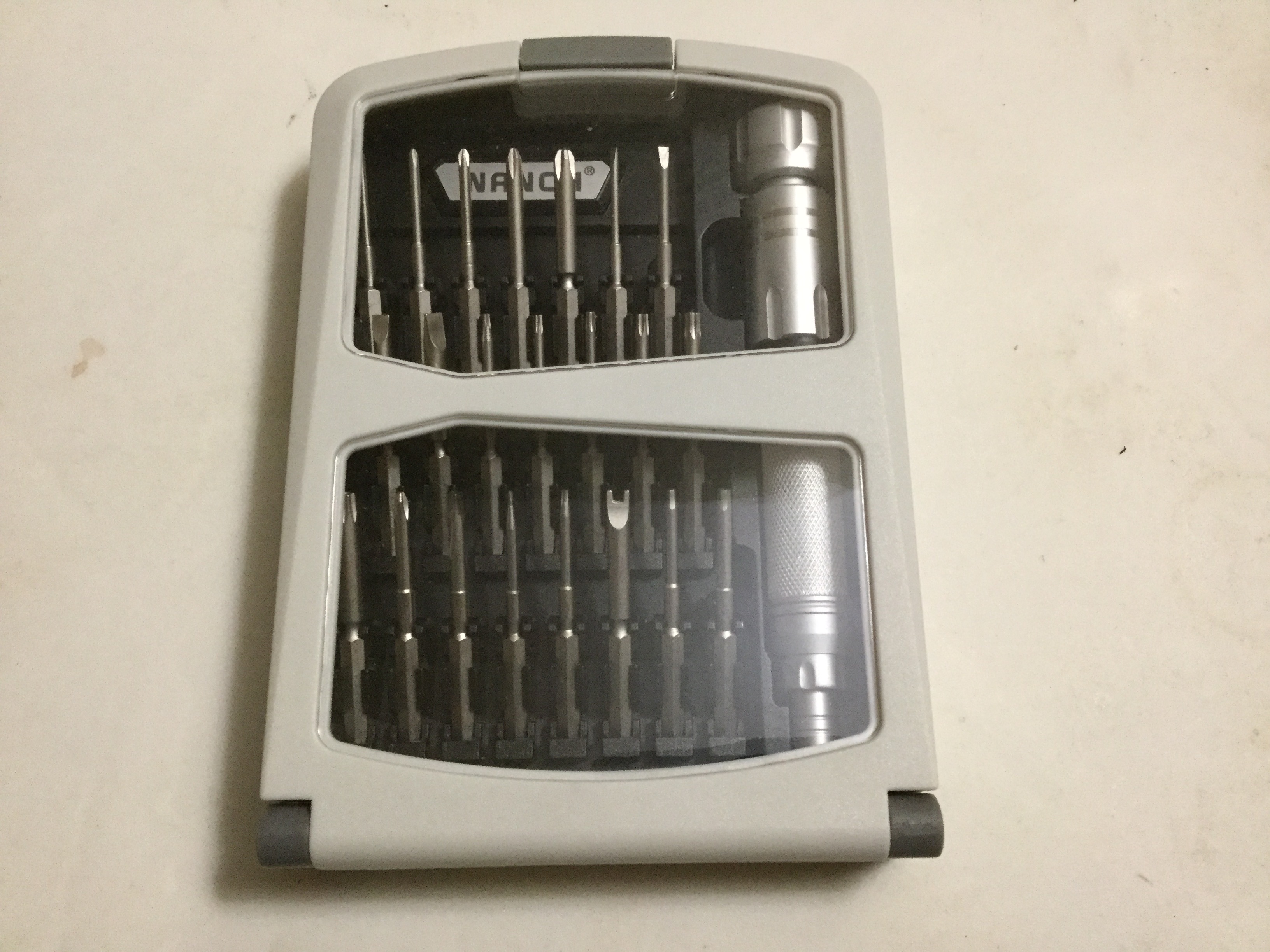

The only snag I hit was for the inner screws. None of the Alan Keys I got in each of the packs could loosen these screws (there is also a cylindrical sleeve with these). In other words, I have the mounts secured with fours screws at each motor. I keep checking after each flight and everything seems absolutely perfect. An elegant solution to extend the life of this great drone - what is there not to like ?
The original screws, including the ones in the back, use T8. My Nanch set T8 fits all 6 but the one included does not fit the rear Stupid. I didn't know that until you just told me. I just went through a whole box of Allen wrenches and none will fit that screw only T8 Torx wrench will work. Sorry about that but I would recommend installing those rear screws. My Nanch set is $20 at Amazon. I'm sure you can get a T8 at a hardware store.
Note: The wrenches in the new set work with the new screws.
This inexpensive kit Will fix anything you need on a drone, and other household projects. Nanch $20 Amazon.
