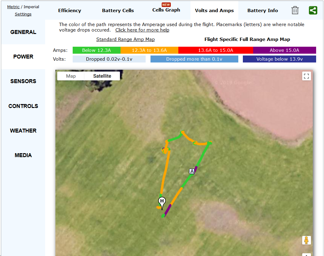

Go to airdata.com and open a free account. Upload your flight log and you can get all kinds of data regarding our flight.
Once you have the flight selected from the list, click on Power (just below general) and you will find multiple tabs that look like this
This flight was for the sole purpose of photographing a mountain range so it was hovering almost the entire flight.
Maybe this helps.
Maybe this helps.
How do you upload your flight log to this? I would like to try it.
