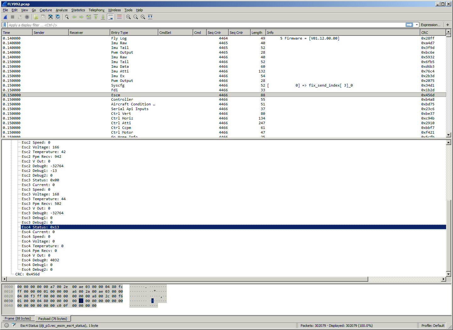

Wireshark esc status after motor coil damage
Removing prop guard and tightening the too long screw again caused motor coil damage and ESC Status Error. Error code and ESC index visible in DAT logs.
