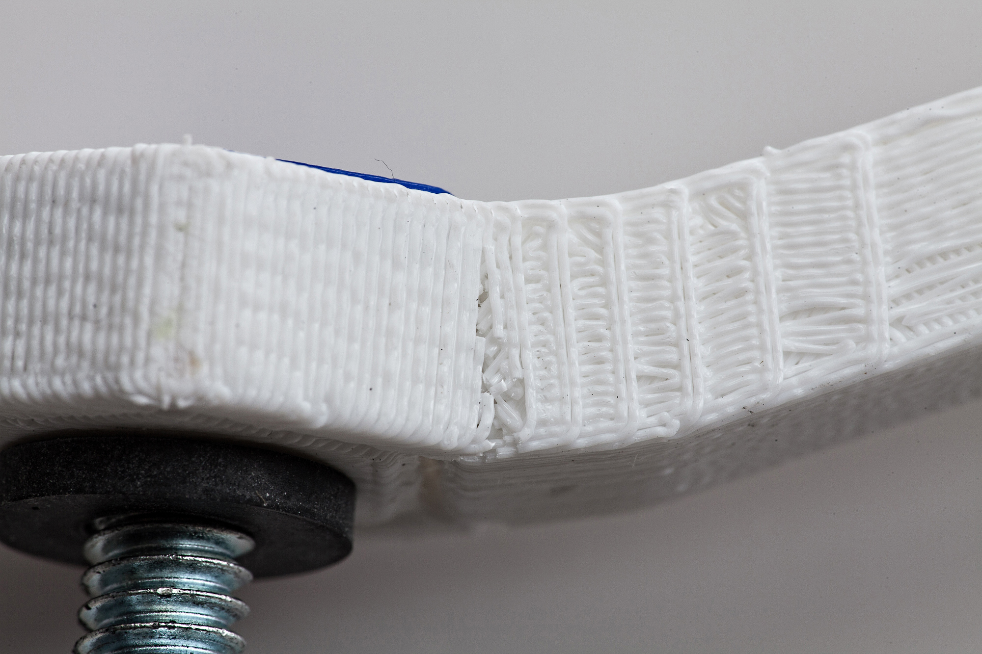

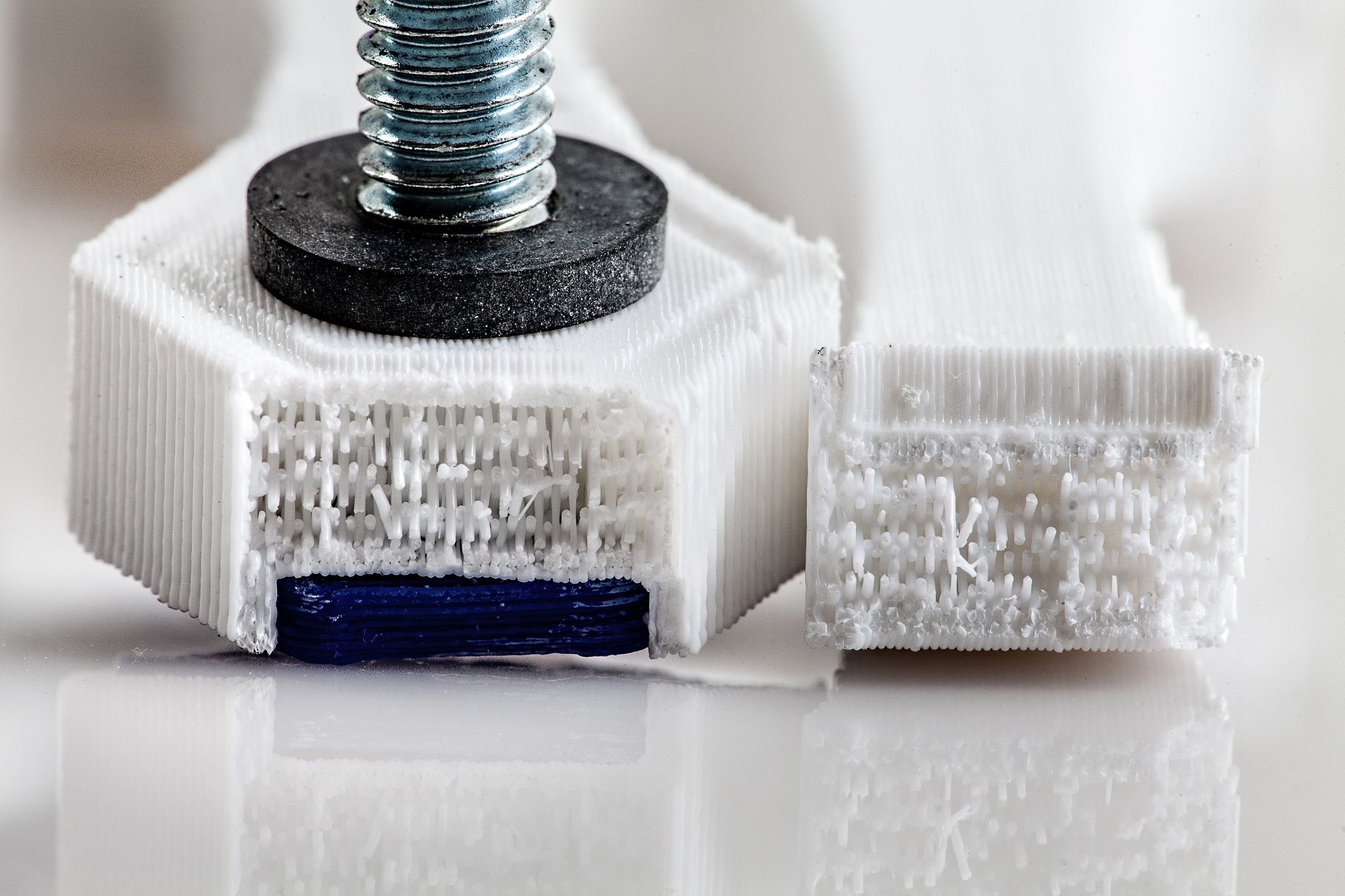

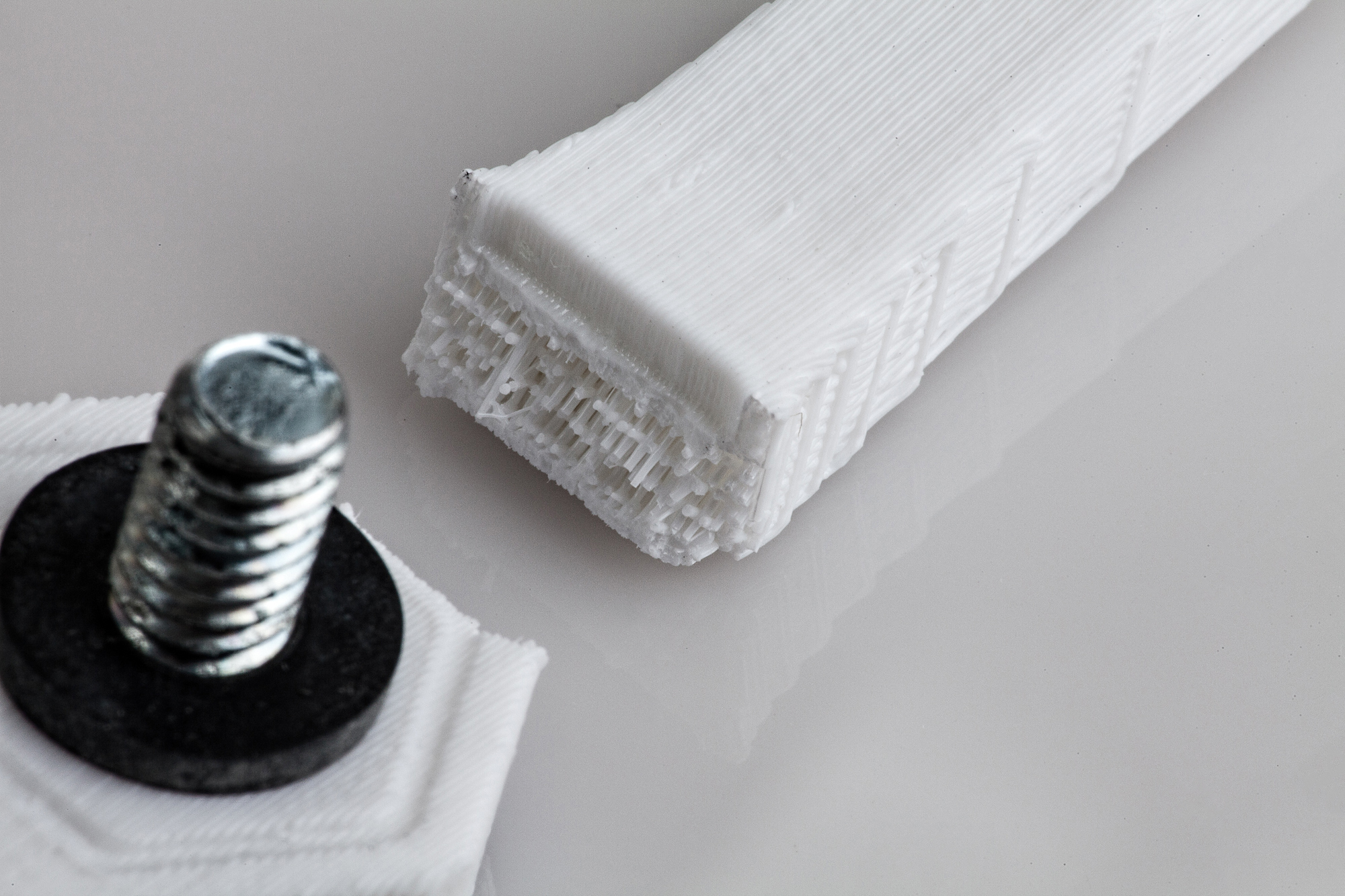

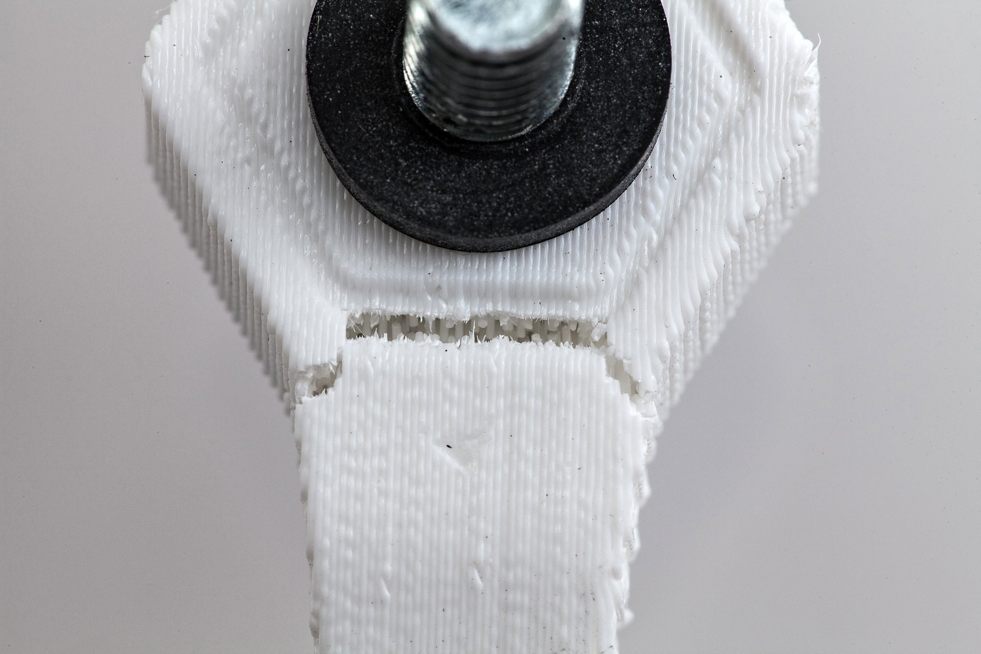

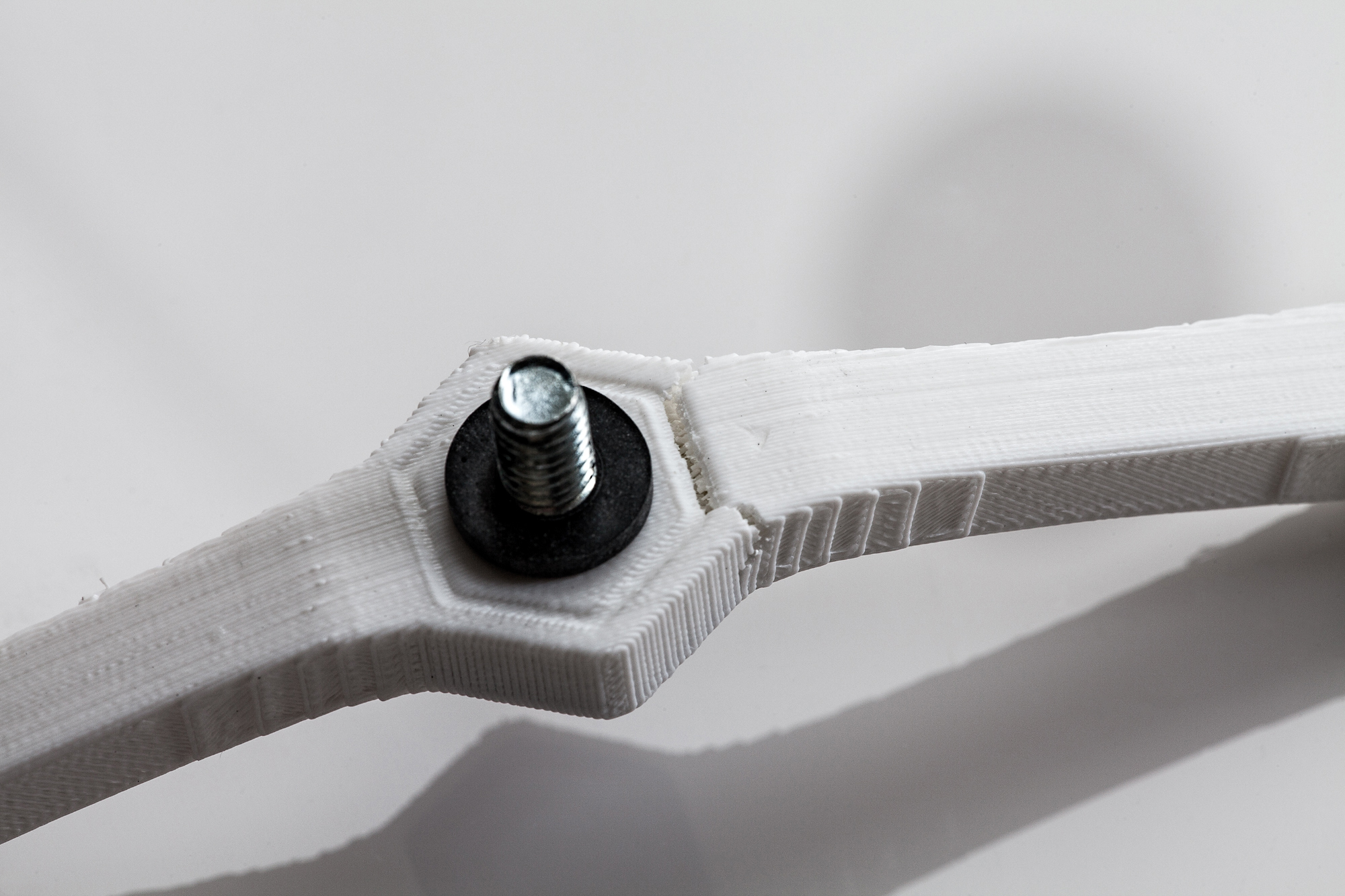

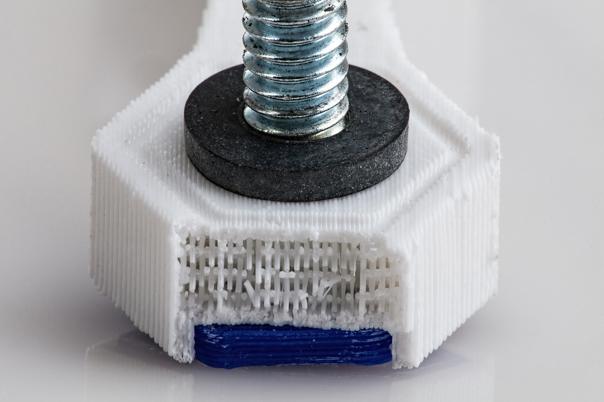

...FYI FOR LUMECUBE USERS: just got the dual lumecube kit - placed the mounts on the P4 - mounted the lights on the mount - played with the lights inside the house for a while, then packed the P4 in a carefully configured thinktank bag and put bag on shelf - went to take the bird out less than a week later and the right mount looked askew - as I picked it up all the way it just gently cracked cleanly in half right at the connection to the blue center disk where the cube attaches - after looking at the left one, it had started to develop the same crack - I took close-ups of the mounts and it would seem the material is more of an air-filled honeycomb, maybe 3D printed, and does not appear to provide the degree of rubbery flexibility necessary to be a solid and safe solution - they were a tight fit to get on, so I can only imagine that maybe the flexing of putting them in place on the legs stressed them to the point of failure...but however it happened, I would just hate to see someone drop one of those relatively heavy little metal cubes on someone's head from 400 feet...so; if you are using that system, PLEASE CHECK YOUR LUMECUBE MOUNTS FOR CRACKING!

I had one crack on day 1 in the same place.
thats a horrible 3D printed job, looks like the ABS filament was not heated to the correct temperature. They must send you a brand new ones.
If the outside of the part looks like your pic, you should undoubtedly reject it!
I totally agree, a very crappy 3D print job! And by the pics, I think I'd have called them to inform them of the looks even before installing them!
