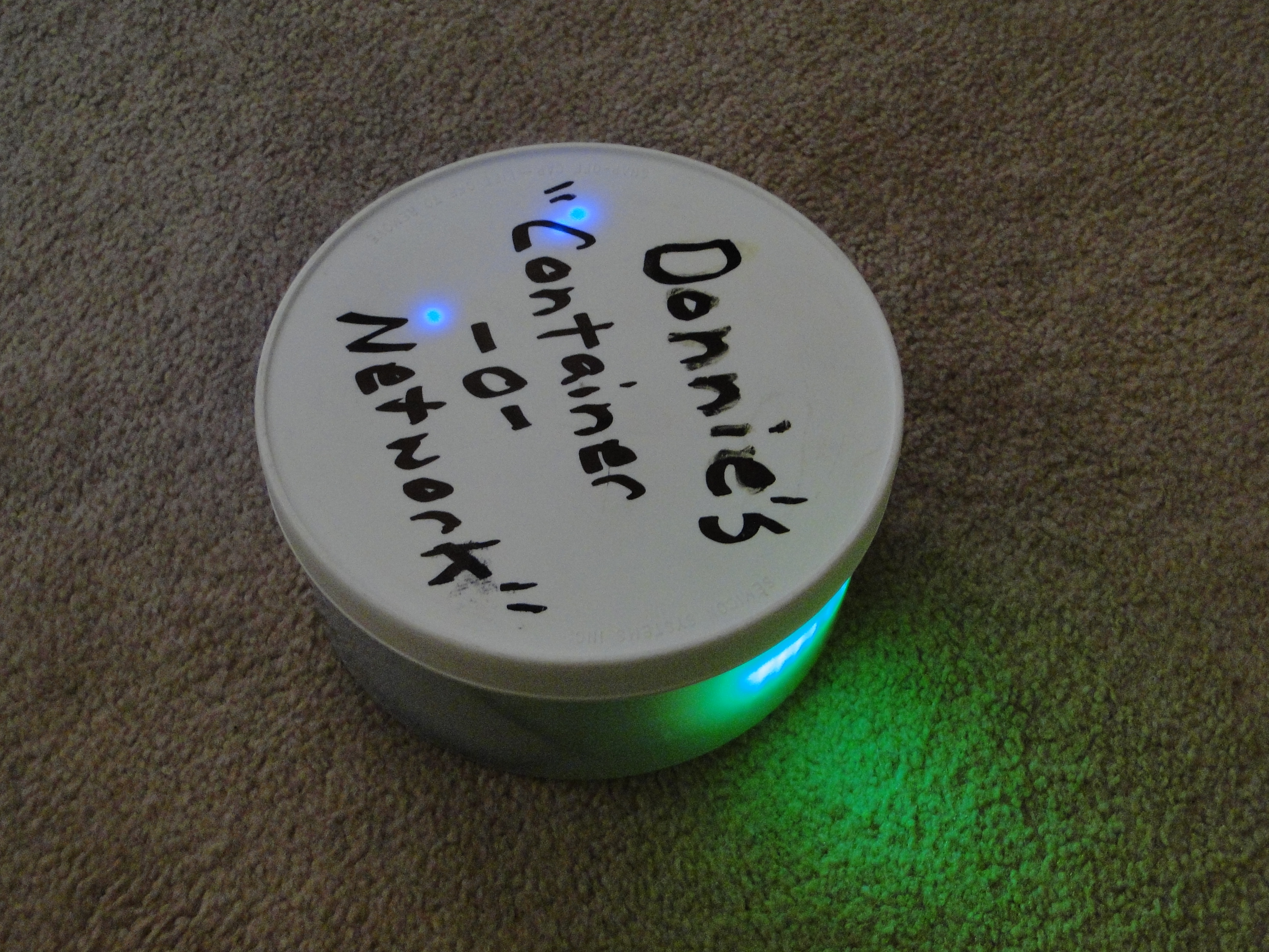

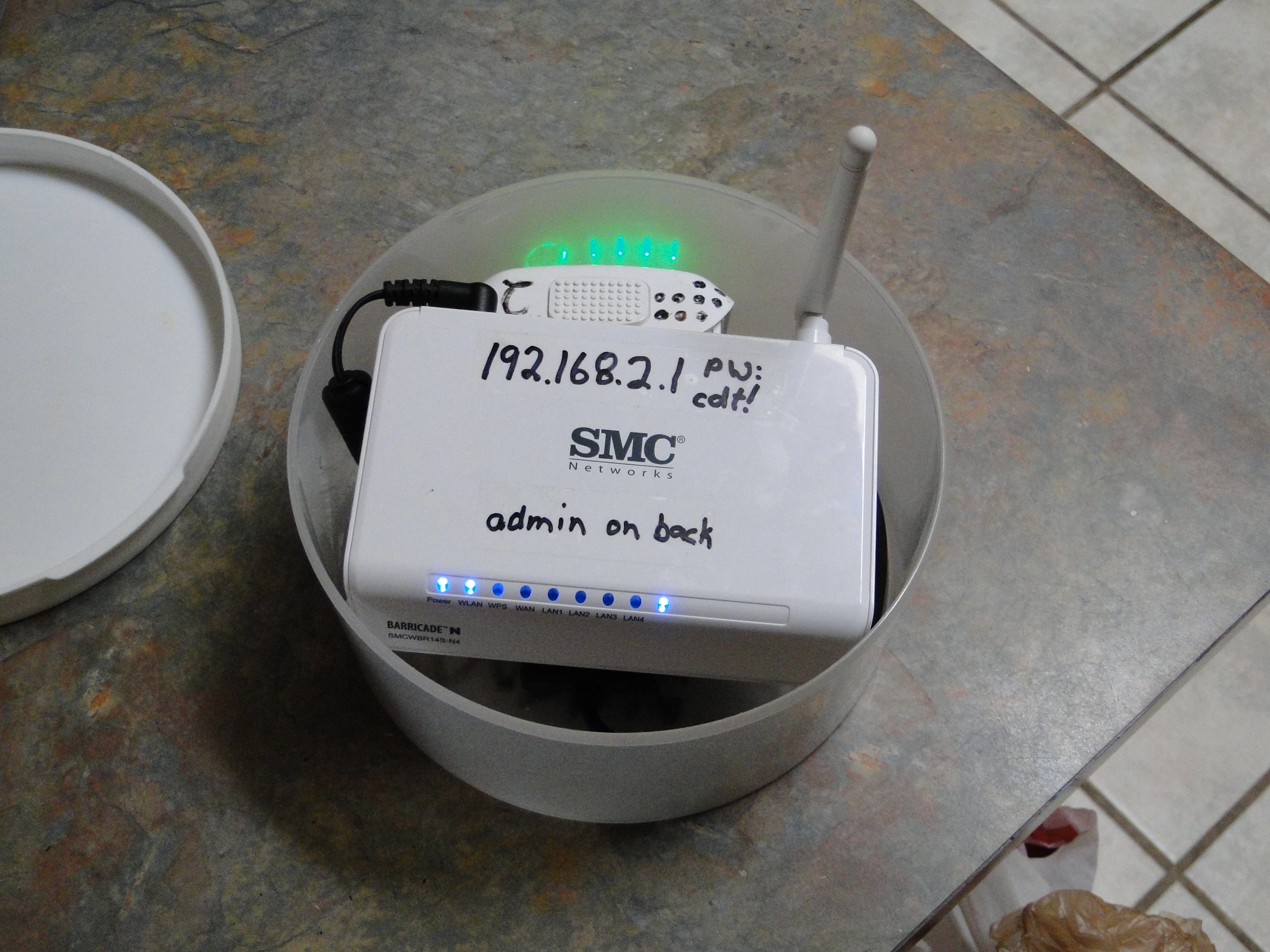

I use old P4P batteries to run my mobile network. They'll run my wireless router for about 30 hours. I love having the LED capacity lights. Perfect for field operations. Each dot on the battery represents 10 flights. Needless to say, this battery was retired.
I made this well over a year ago. I don't remember the pinout. I purchased the adapter cable from a company that is now defunct.
