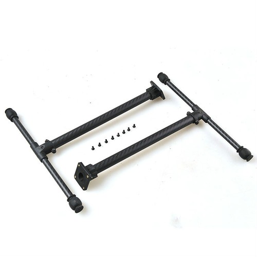

so my drone is in pieces and i'm grounded :eek:
not because of a crash, but because it's getting a serious landing gear upgrade.
so i ordered these
and this
to create some landing gear that i could remove with 1 screw on each side, thus still fitting in the case i bought for it.
the carbon fiber is 1/16" and i have decided to double up on each side to make it 1/8" thick.
here's my 3rd prototype and the one that finally got bolted on.
so now that i have the template, i need to dremel my way through 3 more.
the landing gear is awful tall, so i will probably cut that down too, as long as i stay out of the gopro view. stability and getting out of the camera view was my reason for upgrading.
i plan on leaving the the leg that has the compass on it in place, or leaving the compass portion in place and cutting the rest off (member marlin009 did this and gave me the idea).
so i have longer screws ordered too. once those arrive i will have a fully intact bird again.

i just wifi'd the gopro and decided cutting 3" from each leg would keep it completely out of the camera view.
done, 3 inches taken of each leg...
manufacturing continues...
back in the air !!!!

thanks... last night after a couple of flights, i cut another inch off of each leg. i was still getting the left skid just a bit...
i do believe these extended legs have affected performance just a bit. she still flies for the same amount of time, but just doesn't seem quite as nimble in the air to me.
not sure, will fly again soon. not saying it affects flight, it still flies well, just doesn't seem as smooth...
